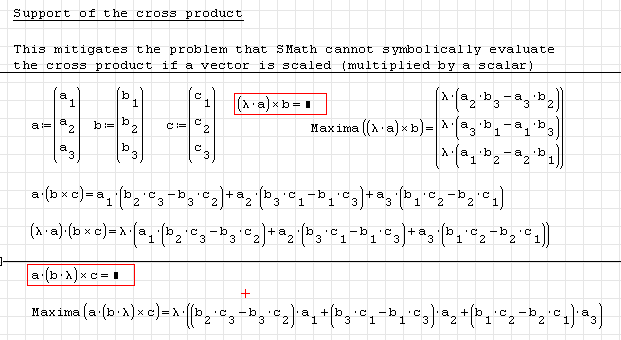

SMath fails to compute the cross product of two vectors, if one of them (or possibly both) is a product with a symbolic constant and a vector (a scaled vector).
SMath complains that the vector product is only defined for three-element vectors.
This is particularly nasty, as this applies also to vectors normalized by division by their length.
#2 Posted: 2013/11/24 14:08:27
1,353 likes in 2,264 posts.
Issue can be solved by using Update 6 of the Maxima Plugin.
