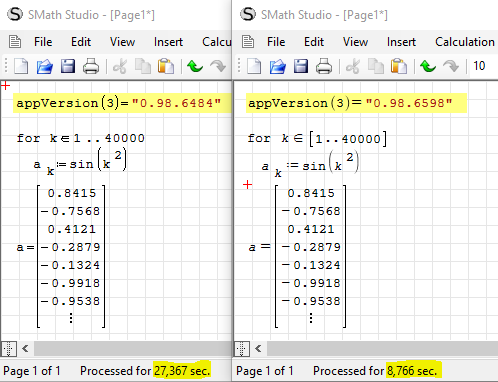

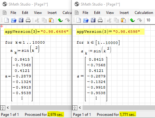

Regarding performance improvement (comparing latest stable and current nightly build):
Symbolic optimization (10000 items):
Numeric optimization (40000 items):

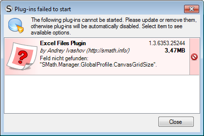

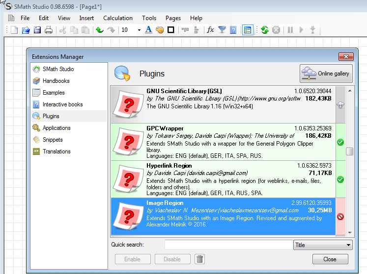

There is a strange user experience when installing plugins.
In the extension manager, everything (didn't install really everything, just the usual candidates) seems to be ok, except for the image region:
![2018-01-25 22_41_29-SMath Studio 0.98.6598 - [Page1_].png](/zh-Hans-CN/files/Download/kSszUN/2018-01-25-22_41_29-SMath-Studio-0.98.6598---[Page1_].png)
Then I close SMath and restart:

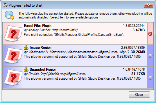

Then I update the just installed plugins, after restart I get this:
Image region works.
Snapshot region saves to the desktop instead to the document directory by default.

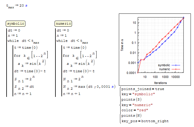

Symbolic element access costs scale over-linearly with vector size, numeric scales linearly
