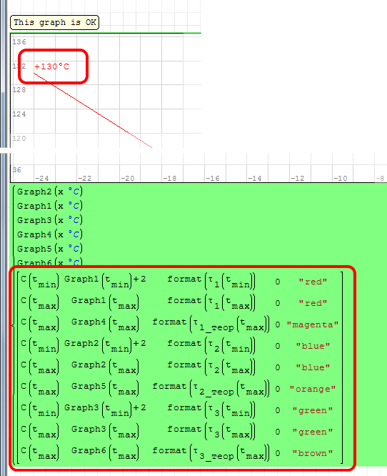

I cannot force 2D graph to show labels that I prepare in a variable.
Here are the screenshot of normal view, made when I construct labels in input data area:
You may see that there is a label near line end.
When I put the labels in a variable, and try to display the result, I see no labels:
Here is the file: temp.sm (50.01 KiB) downloaded 1030 time(s).
Could you please help me understand what I do wrong?

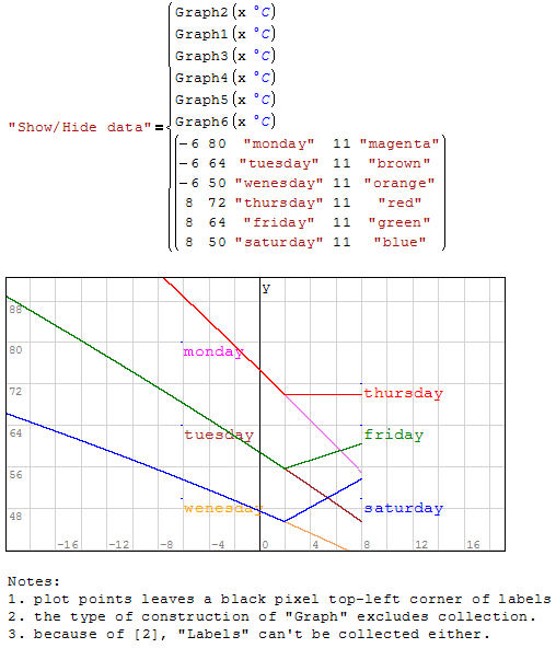

You can collect and plot as single argument:
collect(x):={sin(x),cos(x),ln(x),,,,,}
The style of construction of "Graphs" is not collectable
it excludes as well from collecting "Labels"
