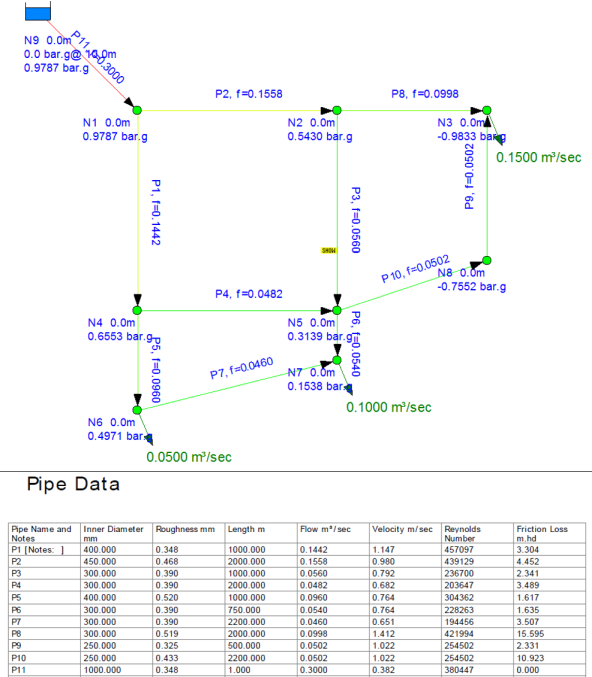

I have made your example in the Epanet program, the results are shown in the graph below.
For the network to be valid, Node A must have an input pressure equal to or greater than 129.4 mH2O,
and Node C equal to or greater than 150.28 mH2O.
NDTM Amarasekera 2022/4/15 02:01:00

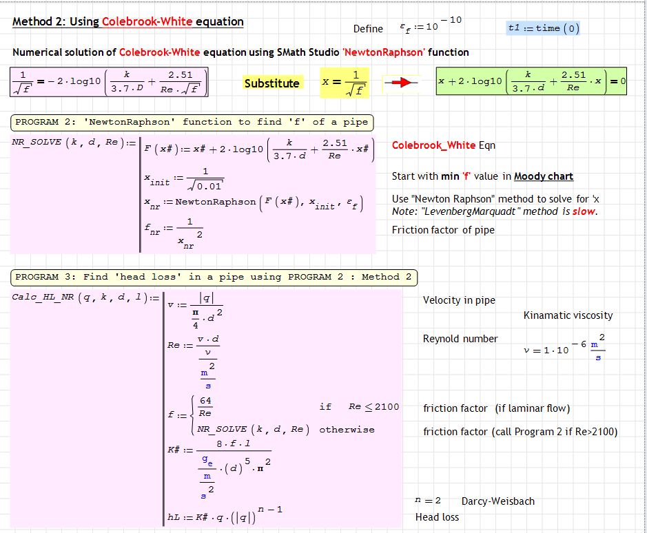

The subject revisited.
In my original post #1, the K values were simply computed using a given formula,
and head loss in each pipe computed accordingly.
In Method 1 of the attached example, friction factors (f) depend on the Reynold numbers (Re)
of each pipe and computed using a given formula involving Re.
In Method 2, NewtonRapson function of SMath is used for the numerical solution of the
implicit Colebrook-White equation to find f.
Many thanks to Ber7, Alvaro and Carlos for your earlier suggestions on the subject.
Overdetermined_Pipe_Network_3 LOOPS-As per CHEGUIDE_al_nleqsolve.sm (286.41 KiB) downloaded 1327 time(s).
Overdetermined_Pipe_Network_3 LOOPS-As per CHEGUIDE_al_nleqsolve.pdf (581.61 KiB) downloaded 720 time(s).

Hello ndtmda
Here are the results of your example calculated
with a very old version of Pipe Flow Expert.

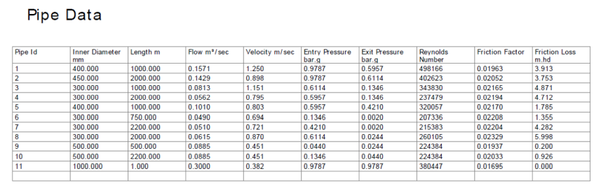

Hello Carlos
Can you please explain how the marked values of gauge pressures are calculated?
Thank you.
#13 Posted: 2022/6/6 23:31:51
CBG
CBG
78 likes in 312 posts.
Hello Ndtma
Hello Carlos
Thank you.
This pressure (0.9787 bar g) is caused by the water level in the tank, which is 10 meters.
The pressure of 0.6553 bar g is obtained by subtracting from the inlet pressure
of 0.9787 bar g. the losses in the pipe of 0.3234 bar g (3.304 m hd)
The system is not correctly resolved for the pressures, since nodes 3 and 8 have
pressures below atmospheric.

#14 Posted: 2022/6/7 00:17:56
NDTM Amarasekera
NDTM Amarasekera
130 likes in 352 posts.
Thank you Carlos.

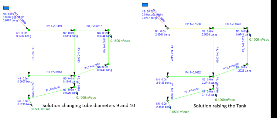

#15 Posted: 2022/6/7 17:20:35
CBG
CBG
Hello Ndtma
Thank you Carlos.
You're welcome.
Changing the diameter of tubes 9 and 10 from 0.25 m diameter to 0.5 m, the problem of negative pressures is solved.
Another way to solve it is by increasing the level below the tank from 0m to 20m. and with the liquid level at 10 m
NDTM Amarasekera 2022/6/7 22:55:00
#16 Posted: 2022/6/7 22:55:01
NDTM Amarasekera
NDTM Amarasekera
You're welcome.
Thank you Carlos. Your contributions are very much appreciated.

Hello Carlos,
Can you please post the Pipe Data Table (with Pipe Number, Inner diameter, ..... Re, Friction Head loss)
for the case Changing the diameter of tubes 9 and 10 from 0.25 m diameter to 0.5 m..
as I get different results for this case.
Hope I am not troubling you.

Hello Ndtma
Hello Carlos,
There is no problem.
Here is the requested table
Davide Carpi 2022/6/12 09:04:00
#19 Posted: 2022/6/11 22:27:18
NDTM Amarasekera
NDTM Amarasekera
Thank you very much Carlos.
