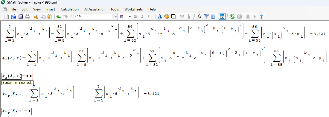

#1 Posted: 2026/5/22 16:47:56
Valery Ochkov
Valery Ochkov
66 likes in 682 posts.
See the end of the sheet.
iapws-1995.sm (220.46 KiB) downloaded 106 time(s).
Edited 2026/5/22 17:26:14

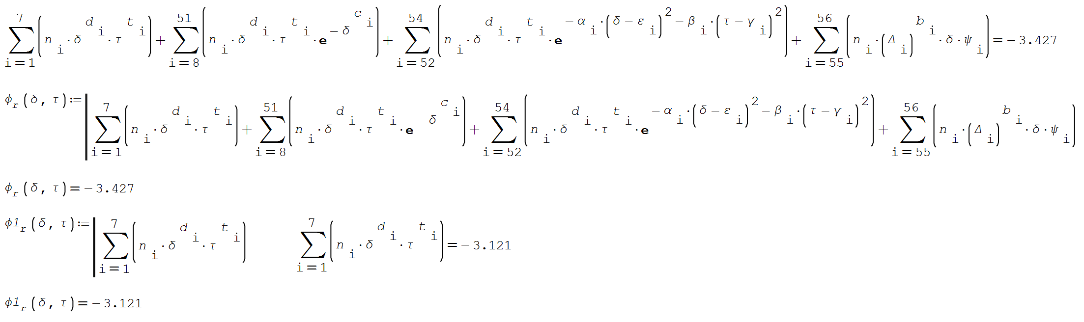

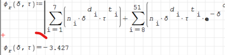

#2 Posted: 2026/5/23 05:08:54
1,106 likes in 1,784 posts.
Hi. Use line(#) for prevent the evaluation.
iapws-1995.sm (220.77 KiB) downloaded 116 time(s).

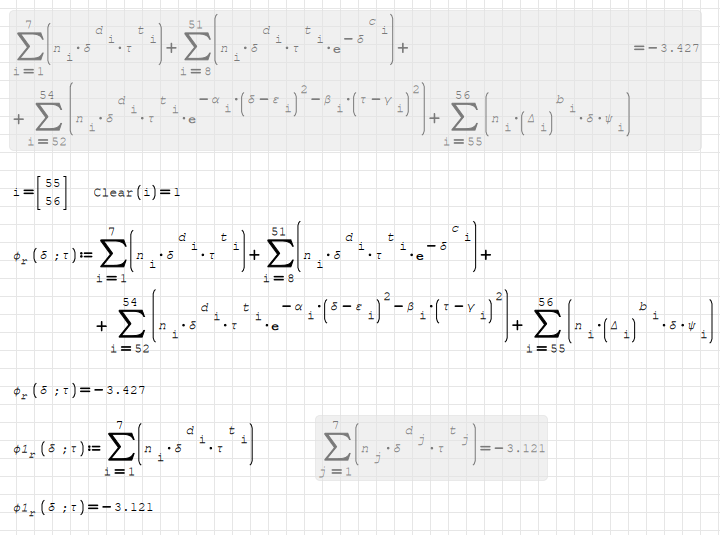

#4 Posted: 2026/5/23 11:03:47
597 likes in 1,377 posts.
This happens because your i is not empty.
Try to clear it or use something different for sum iteration.
j would be appropriate.
Andrey Ivashov 2026/5/23 11:18:20, sergio 2026/5/23 17:20:38

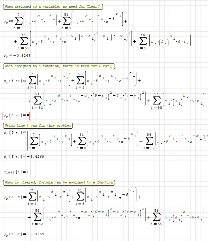

#5 Posted: 2026/5/23 11:19:15
2,326 likes in 4,013 posts.
Thank you overlord!
Another way is to use line() at the rhs:
#6 Posted: 2026/5/23 16:18:22
Don't know if this is a bug or limitation.
But when formula assigned to variable or used directly, it can be calculated.
When assigned to a function, it can't be parsed.
