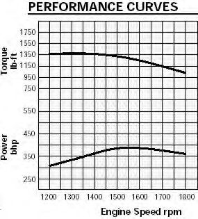

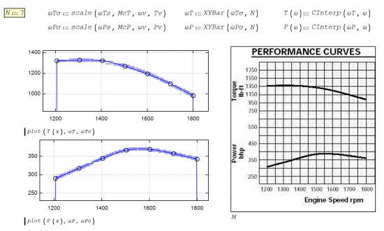

From the textbooks to a SMath evaluable function
Digital Image Function Analysis.sm (538.87 KiB) downloaded 1238 time(s).
Digital Image Function Analysis.pdf (1.56 MiB) downloaded 917 time(s).
Image for the analysis:
overlord 2021/6/15 04:12:00

Hi overlord. Thanks. Do you download the image "imgPerformance.jpg" and put it in the same directory than the sm file? It is the only issue specific for linux that I can see. I know, it is showed instead given the link for download. Here it is as zip file:

Hi. I remember now that the worksheet also use Mean, from statics plugin, and I put it definition at left margin, but disable. Maybe it's that one. This version have embed image matrix, and except for the XYPlot, I guess that it have not any other plugin.
Digital Image Function Analysis - Image embeded.sm (4.02 MiB) downloaded 1177 time(s).

#7 Posted: 2021/6/9 18:05:00
Try this suggestion:
1. Plug one of those dirty image in Paint.
2. zap the X,Y grids.
3. Capture WinGrab and note the X, Y pixels for further scaling.
4. Insert picture, Digitize, clean ... finish project.
Page12 Digitize.sm (1.19 MiB) downloaded 1283 time(s).

Nope. The message says that "M" is not defined, not Ms. And M is for load the image, not for doing some process. Try this version, with the image embeded in the worksheet:
https://en.smath.com/forum/yaf_postsm71146_Approximation-of-a-functional-curve-in-a-digital-image.aspx#post71146
and check if you can update the plugins for images.

#14 Posted: 2021/6/16 08:15:51
Elsid,
My offer via Paint is valid, but delicate from too thick graph.
My other tool is via Tracer 15 [freeware]
Paste image as is in Tracer, capture at will pixels.
Each capture is stacked in vector, obviously noisy.
Once in hand, Ksmooth the Y vector ...
We have Ksmooth as a Smath utilities.
Once smoothed, spline ... Job done.
Have a good day ... Jean

The image2rgb() doesn't work with image importing.
image2rgb has a procedure for fast image reading that somehow doesn't works in mono
I'll try to update a beta version with an alternative code ASAP.
#16 Posted: 2021/6/19 08:14:15
1,441 likes in 2,932 posts.
Just released a beta version of the Custom Functions plugin for latest Stable SMath Studio. Please test if now it works under linux.
