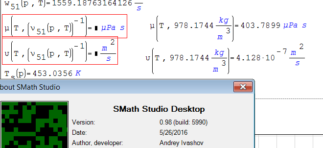

By the way, in SM build 5990 the viscosity calculations under Временные расчёты will throw an error(Units don't match) although units are correct (put them manually and the result is Ok). This error is not present in the previous SM build.
Mike Kaganski 2016/5/28 06:00:00

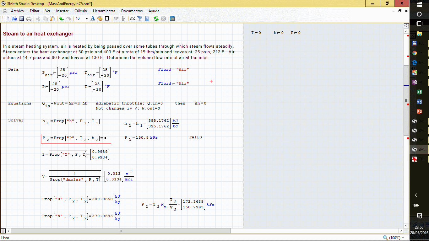

Actually, I haven't yet looked into your calculations deeply, but I feel it strange that you look for pressure of Tetrafluoroethane with T=-20°C and enthalpy=234.55 kJ/kg, the same as at +20°C and P=800 kPa. You marked it "FAILS", and provided manual value of 150.8 kPa, but it cannot be that: how can a liquid at lower temperature AND pressure have the same energy as at higher temperature and pressure? Actually, interpolation says it should be about 140 MPa, far higher than upper limit of EOS (70 MPa).
Yes, I say thanks last week in the post of CoolProps. It's a big effort, and they share they knowdalge and expertise, which is very preciate.
About the fail, which fail is air. And isn't a bug in CoolProps or the wrapper, it's a failure of the model in general: can't derive a dependence between Cp and T, P at the same time. For this reason, which is used is a more simple model for the Cp with a dependence only for the temperature. So, there are no need for poste any issue with CoolProp, because there are not one. Eventually, ask for a new utility: provide ideal gas equations too.

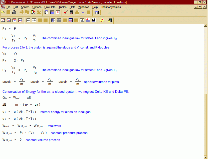

Attached, a capture screen from EES showing u evaluated only as funcion of T.

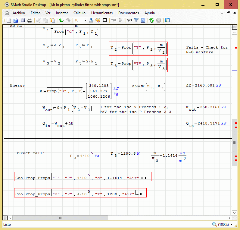

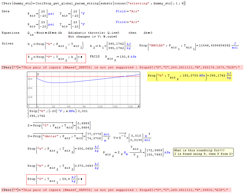

Actually, I couldn't see this in the sheet you've attached earlier: there seem to be a number of problems in the Air section, including using T[1 and P[1 (extracting elements) where T and P are set to be scalar, and it seems T.air and P.air should be used.
Could you please clean up, refine and annotate your example so that your point would be clear, so that I could try to come up with a workaround? Just out of curiosity.
EDIT: If my presumptions are right, then there's no fundamental model shortage in your Air sample, only not-yet-implemented input pair:
MassAndEnergyInCV-air.sm (25.58 KiB)已下载 1518 次。
What is wrong here is trying to use two different models in one solution. You use more precise real-gas model for some system properties, and at the same time want to use simpler ideal-gas model for other properties of the same process. This approach is fundamentally wrong, and cannot give you sensible results.

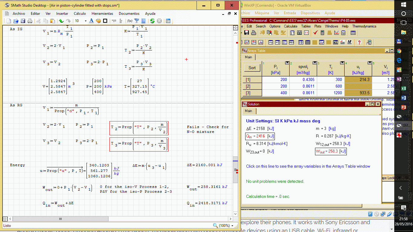

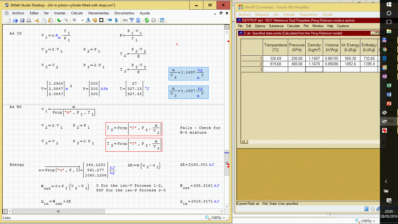

#9 已发布: 2016/5/29 00:24:37
1,139个赞,共1,805个帖子。
Could you please clean up, refine and annotate your example so that your point would be clear, so that I could try to come with a workaround? Just out of curiosity.
T, P are vectors. CoolProp can't work in that region for air, but isn't alone, there are others (like EES, for example).
Refprop can handle this problem, but with Cp(T) (or Cv for u) I guess.
Attached the workaround: use IG equations (Constant K = P1 V1 / T1 = P2 V2 / T2 ) which give very close solutions.
So, attached, the "clean" implementation.
Air in piston-cylinder fitted with stops.sm (34.65 KiB)已下载 1517 次。
Well, this is already fixed in CoolProp version 6.0.0, but the wrapper isn't yet updated, because in 6.0.0, they broke their get_parameter_information_string.
So, there WAS something to submit to them as an issue.

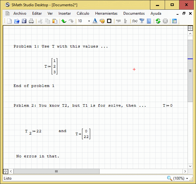

So ... T, P are vectors. T.air, P.air too. Assign's at the left margin like T=0, h=0 as null scalars are usual practice in math cad programs for ensure that redefinitions, like T[2 = xx, don't carry up old values.

No.
When you assign T:=0, in SMath you actually do set T to be scalar 0.
If you then try to use el() on it, like in t:=el(T,1), then you will get an error that argument is not proper.
It doesn't matter that in some other program it may be another way.

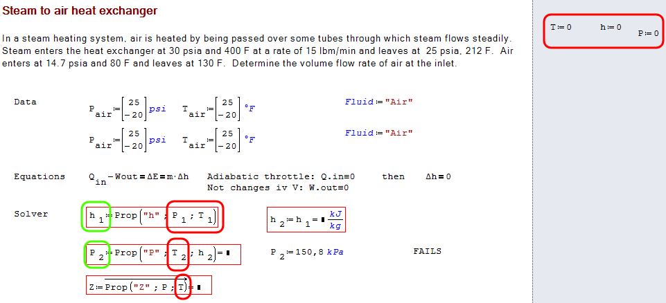

Mike Kaganski
Mike Kaganski
184个赞,共434个帖子。
And that is about of what of my bugs?
Red are places where "elements" of scalars were used (last red is where T is still simply 0, no element, but surely not what was intended).
Greens are where you try to "convert" them to matrices.
С уважением, Михаил Каганский
