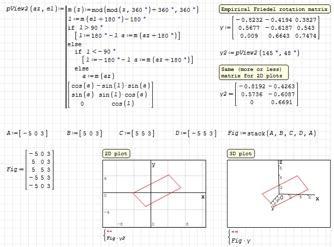

To prevent the 3D graph from changing its perspective, we multiply its matrix by the empirical gamma coefficient.
3d.sm (6.19 KiB) downloaded 1247 time(s).
what does that even mean? I figured out that the matrix should contain coordinates of the points in its rows, but what's the "empirical gamma coefficient"?
#4 Posted: 2021/7/5 20:36:38
... while remembering Fig*γ is not commutative.

it's buggy though, one would expect graph to not change it's view whenever anything changes, and numbers are disappearing from the axes too, which is super odd.
#6 Posted: 2021/7/5 21:22:41
Fridel gave you the minimalist guidance/model 3 cols + rotation.
The 3D plot has a fixed native orientation,
then rotate manually to better view, then capture as fixed image.

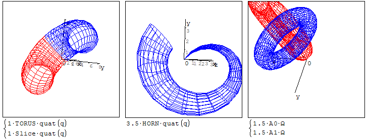

Rotate 3D TREASURY_5 Quaternions MODULO Explorer.sm (71.8 KiB) downloaded 1286 time(s).
3d.sm (13.76 KiB) downloaded 1244 time(s).
isn't it a workaround for a problem with smath itself?

what am I supposed to look for it there ?
1. open 3D, assign plot argument
2. show/hide axes/grid
3. 3.5*HORN*quat(q)...3.5 zoom at will
4. quat(q) the Quaternion rotation system
5. 'q' 1/24 pre-rotation [Quaternion]
5. mesh CreateMesh either/both directions
6. rotate the 3D manually

... look for more.
Rotate Sphere ANIM.sm (25.04 KiB) downloaded 1222 time(s).
Nope. That was my failed attempt to answer your very specific question about what gamma was, but you seem to have lost interest in it given that you comment my answer with another unrelated question as well.
I am reporting a buggy behaviour of a 3D graph
Well, I would not agree to say that it is a buggy behavior, but simply that component restores the default view when recalculating, which does not seem erratic behavior, except that you fix it by means of a rotation matrix, which, like we know, you don't seem to be interested anymore.
