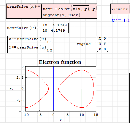

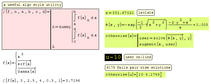

Interesting the implicit/recursive discrete solver.
Few more techniques/tools in these two Smath documents.
Contour SOLVE [user].sm (46.96 KiB)已下载 1061 次。
Contour SOLVE [at(2)].sm (174.57 KiB)已下载 1080 次。

Few more techniques/tools in this Smath document.
... lobes added

For sure, more than correct as your solve(,,) gets pair wise solutions.
Yes, the lobe is symmetric around the 0 datum.
... now I get pair wise solutions. But not augment !
