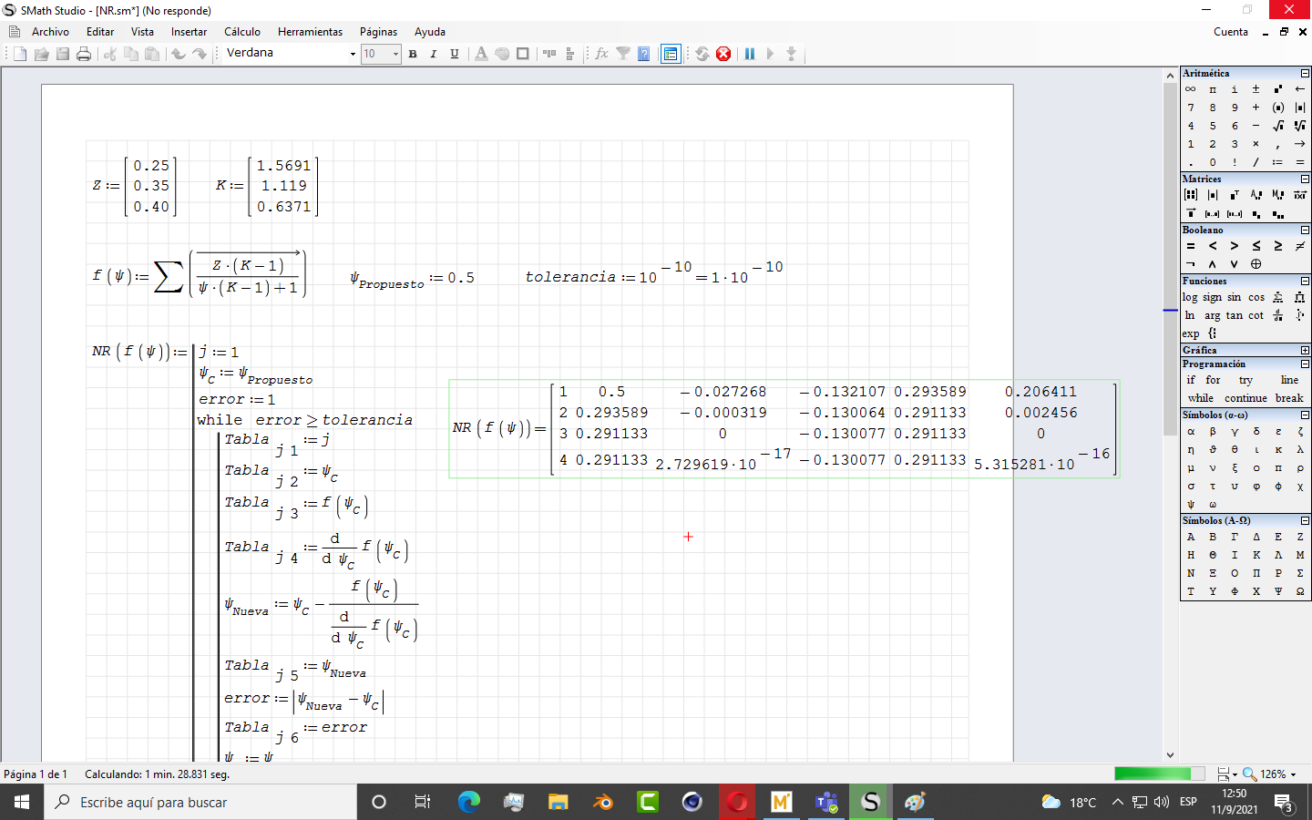

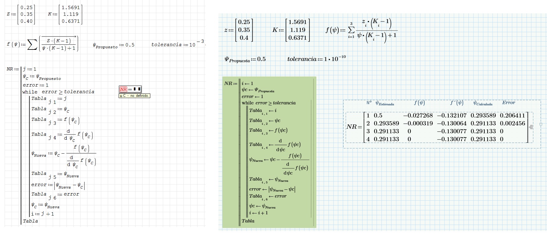

How can I do this loop while?
what am I doing wrong?
NR.sm (8.06 KiB)已下载 1216 次。

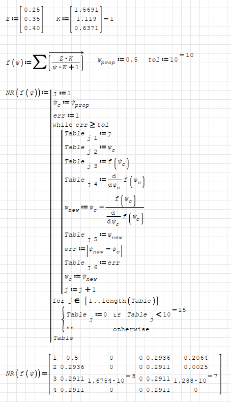

I think it already came out, but how do I make the numbers that are almost 0 not appear as 2.72 * 10 ^ -17?
#3 已发布: 2021/9/11 15:23:39
600个赞,共1,381个帖子。
Add a check for every element if they are lower than something.
And if they are, make them zero.

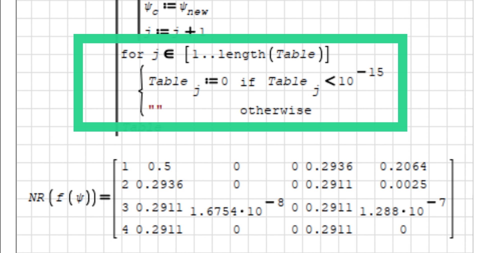

what function does this have?
Thank you so much
#5 已发布: 2021/9/11 16:09:46
600个赞,共1,381个帖子。
That is cases(), it is in Custom Functions plugin.

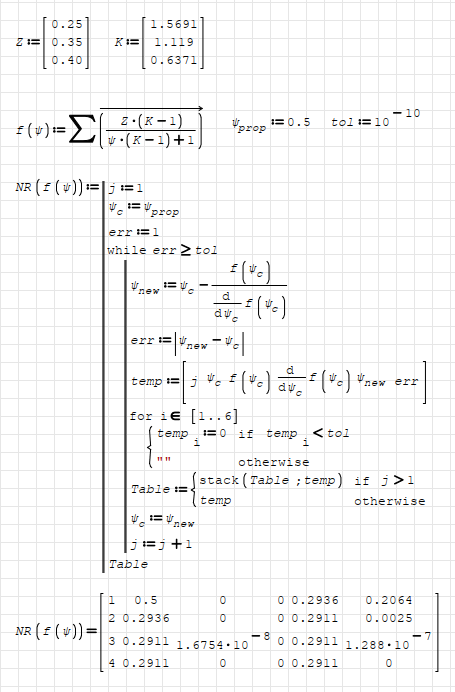

I would prefer to write your algorithm like attached.
It is just my preference by the way.
NR_r1.sm (9.6 KiB)已下载 1224 次。
