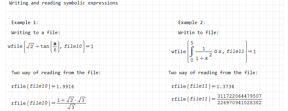

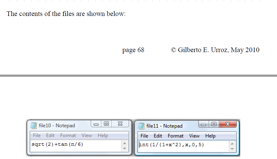

I am studying with Introduction to the use of SMath Studio Prepared by Gilberto E. Urroz, May 2010
p68
i try to that.
The saved file looks like this
未找到文件。未找到文件。
why are files different?

Obviously, there was no preprocessing of the expression in the old version of the program.
