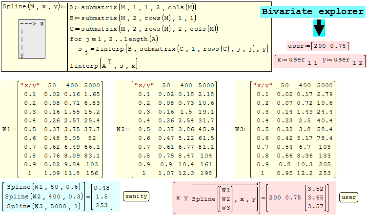

Spline/Interpolate Matrix
Spline/Interpolate Matrix - Spline/Interpolate Matrix - Messages
#1 Posted: 2017/11/22 22:45:06
Spline Matrix Tutorial METRIC Domain.sm (88.16 KiB) downloaded 1113 time(s).
frapuano 2017/11/23 03:48:00, sergio 2017/11/23 08:36:00
#2 Posted: 2017/11/23 08:39:27
The bivariate "linterp" is reputed behaves like Quadratic
Spline Matrix Tutorial METRIC Domain EXPLORER.sm (14.73 KiB) downloaded 1050 time(s).
