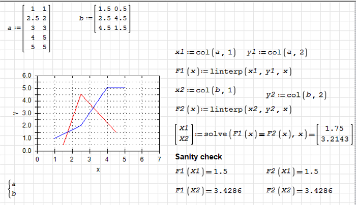

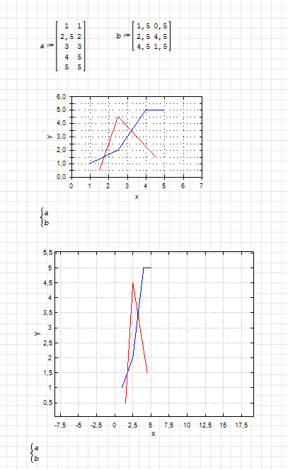

How to find the intersection of two matrices. Sorry if I said wrong. An example is attached, a graph is built in it. The graph shows that there are two intersections. How do I find the intersection coordinates.
I have such a task. I need to get the third matrix, which begins as matrix (a), and after the intersection is constructed as matrix ( b ). Maybe someone knows the finished function. The matrices that we use in the problem always have two columns and a different number of rows. In the form of a matrix, we digitize graphs so that we can work with them.

The linterp does your digitizing project.

WrotePompelmoTell,This is just a great calculation. I never thought that finding intersection points was such a difficult task. I was preparing for something simple. Thank you so much, for I came up with my own method, which is many times simpler and only suits my types of graphs, when the construction goes from top to bottom, from left to right.
