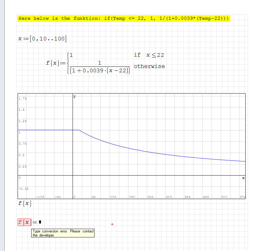

Hello everybody,
I use a beta-Version of SMath and have a question regarding the message:
"Type conversion error. Please contac the developer"
Problem_with_the_function.sm (4.31 KiB)已下载 1140 次。

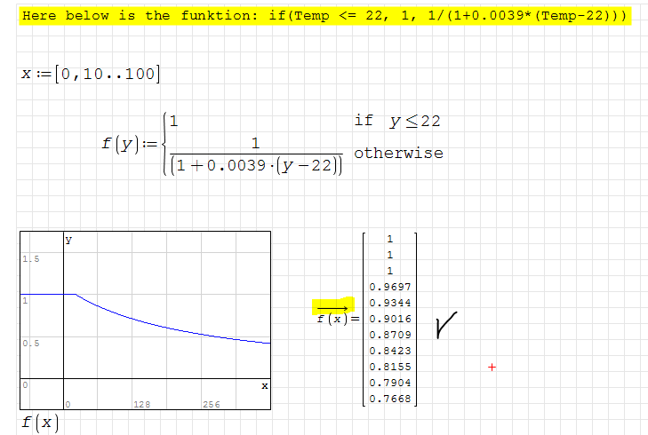

127个赞,共342个帖子。
Do you want to get this result?
Problem_with_the_function_ser.sm (4.83 KiB)已下载 1200 次。
Assign value for evaluation.
Problem_with_the_function.sm (5.08 KiB)已下载 1154 次。
