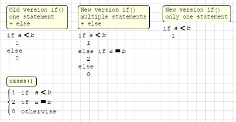

Hello dear Smath Users,
I accidentally pressed the keyboard once and created an Else-If statement like this:
Lately I have been struggling to find this option of an Else If statement on Smath studio.
There seemed to be no information on this topic anywhere.
So I figured it out myself:
--Type "if" and press the TAB key.
--Click in the place above the "Else" portion of the If statement.
--Now press ";" and you should get an If Else-If statement.
Kind Regards!
#2 已发布: 2023/12/13 22:22:09
983个赞,共6,866个帖子。
1. if/else from program palette
2. alternately from fx menu
3. if/otherwise from fx menu cases
#3 已发布: 2023/12/14 00:29:25
1,362个赞,共2,276个帖子。
You add and remove entries just as within vectors or lists (sys) or command blocks (line). If you don't need command blocks in the entries, then probably the cases() function from the custom functions plugin is more reader-friendly than cascades of if().

#5 已发布: 2023/12/14 08:43:51
600个赞,共1,381个帖子。
Original if() didn't have else if just over a year ago.
Only persistent else statement existed with one if.
Nowadays you can even eliminate else.

Good evening. Somehow the shortcut keys for this one doesn't work for me. Am I doing it right?
Edit. I figured it out already. Under Tools > Options I can set the "Arguments separator" to semicolon
已编辑 2025/9/10 12:09:13
#7 已发布: 2025/9/10 19:16:15
1,443个赞,共2,936个帖子。
You are not forced to change your settings, though. Just use the argument separator you prefer instead of the one in the screenshot (if your is comma, use comma to add arguments instead of the semicolon).
