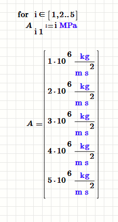

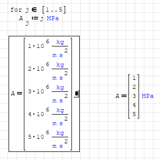

#3 Posted: 2023/10/23 00:36:13
If you want to preserve MPa ... in the A result,
in the for loop multiply i*silent MPa
Silent is 'MPa
#4 Posted: 2023/10/23 07:09:50
597 likes in 1,377 posts.
1 - There is no permanent SI/Imperial option.
You can easily input imperial units to variables.
Yet SMath works with SI Units under the hood.
Even if you input variables in imperial, results will be in SI.
However, results can be shown in imperial too.
Just click to result, a placeholder will appear.
Input your desired unit at there.
Unfortunately you have to manually alter every result.
2 - You can't change individual units of result matrix as explained above.
Yet you can input a unit to placeholder of result matrix.
If every element have same units, it will be beautiful.
If not, it will be a mess. Try to learn table region plugin for that purpose.
