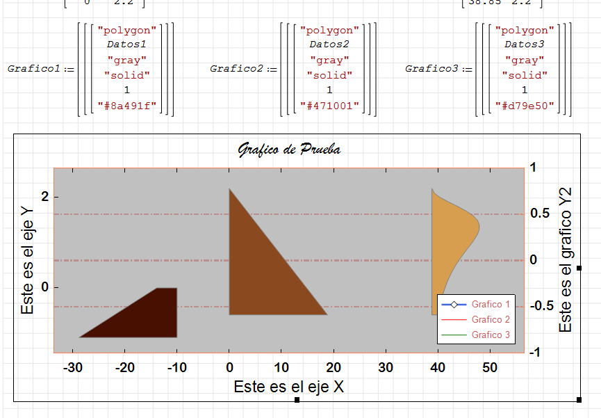

It's possible with XY Plot plugin
FilledArea.sm (15.59 KiB) downloaded 1400 time(s).

The idea was setting a color for the interior of a Area Region, not for a XY Plot Region. But thanks, Renzorex!

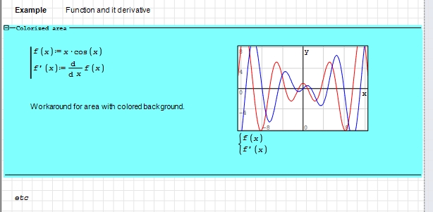

Hi. Agree, it could be a very nice feature. Just like books with different background color for text, samples, problems and case studies.
ColorizedArea.sm (5.46 KiB) downloaded 1410 time(s).
