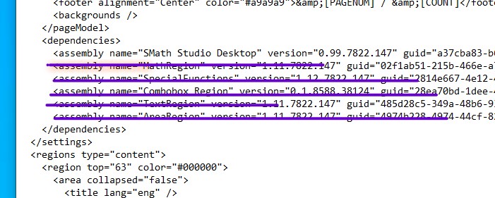

Greetings,
I have a similar issue; I am still using the 0.99 version, but the issue I noticed is with regards to management of versions (app and plugins) and shouldn't be ignored as version management is a HUGE perk of SMath; that it is backwards AND forwards compatible.

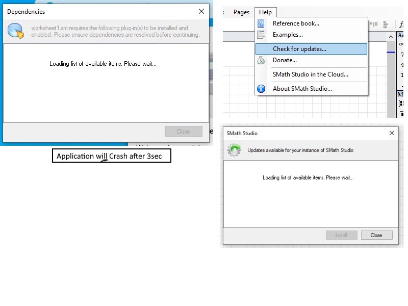

This is an annoying bug as it doesn't give you any context, it just closes the application after 3seconds of trying to update plugins (if you have sufficient plugin versions, it doesn't try to update, and it doesn't crash as a result:
There is an easy work-around, just to delete (or correct) the plugin dependents within the SMath file you are accessing.

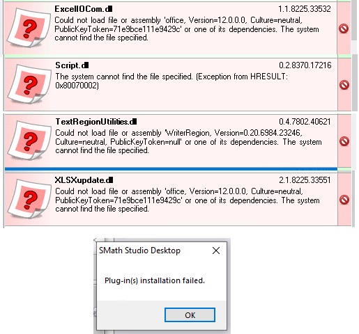

To the best of my knowledge, there are at lest (4) bad plugins that will not install:
  • "...\plugins\0370e95d-cfdf-4f76-96cb-468d63d765c0"
  • "...\plugins\a9f5e37d-83f5-4a4b-a106-0ba7b202abbb"
  • "...\plugins\e40eaef6-4622-4ef3-ad03-077e8f005bb1"
  • "...\plugins\20ad815b-bc5e-487d-9258-57fde2ac6de8"
I think the issue is that the program never addressed the possibility that a plugin that throws errors/doesn't work would ever be posted. As such, I believe that if ADMIN removes these (4) plugins from the online gallery, functionality of the 'checking for updates' will be restored:
May this be of Good Help;
⚜ Kenny Lemens, P.E. ᵂᴵ

As it is, I am running appVersion(4)="0.99.7822.147" and SMath does not support the ability to download/update, nor is it possible to view the online gallery [NOTE: I don't even use the (4) plugins that I identified]. I am noticing the same behavior as MarB:
But, even if no file is open, SMath crashes if I call "Search for updates" or if I open the plugins dialogue and select "Online gallery".
Blow is an error message I captured before the crash. I cannot see much information, but it provides some context (i.e. an XML exception):
显示剧透
[FOLLOWUP]: I will concede, this may not be due to the plugins as the ability to check for updates on the software, or to access any of the online galleries contained within the Extensions Manager, will result in a crash. As such, disabling the (4) 'bad' plugins probably would have ZERO effect on addressing the underlining cause...
