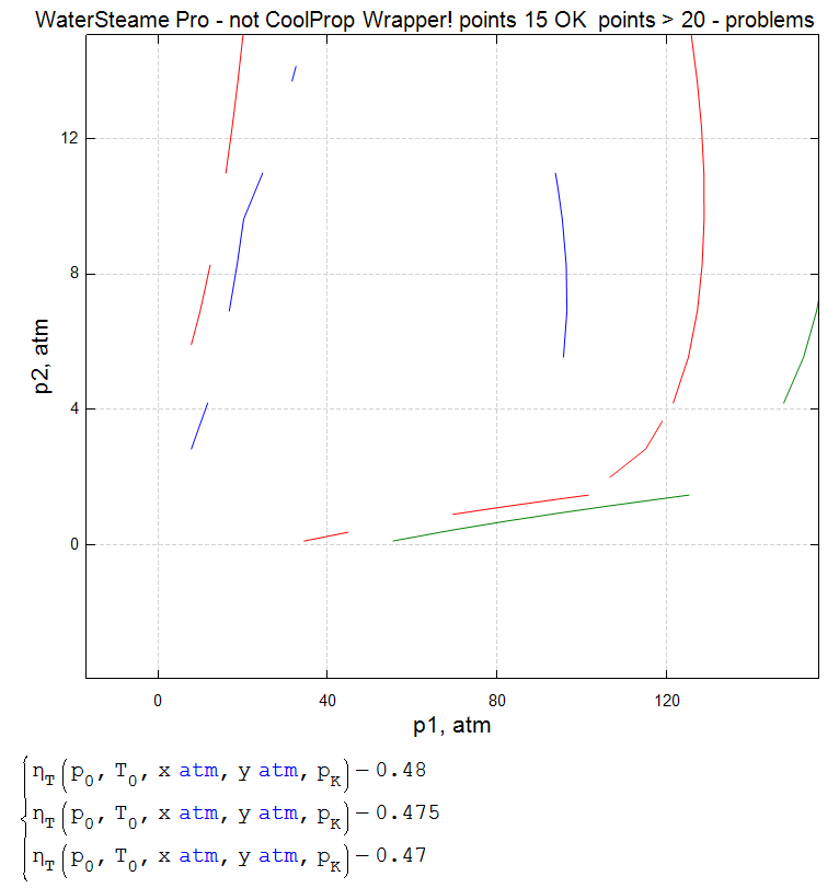

h(p1, p2) implicit plot
h(p1, p2) implicit plot - Why I can not create it? - Messages

Implicit.pngscratch geometry dash
The graph you've provided seems to show a relationship between two pressures 𝑝1and 𝑝2, with annotations related to efficiency calculations.
Axes:𝑝1 on the x-axis (measured in atm). 𝑝2 on the y-axis (measured in atm).
Curves: Different colored curves (red, blue, and green) that might represent different states or processes in a thermodynamic cycle or system, such as isobars, isotherms, or other state transitions.
Water/Steam Cycle: Given the mention of "WaterSteame Pro," this graph might be related to a water/steam cycle analysis, such as a Rankine cycle or steam turbine efficiency calculation.
Efficiency (𝜂): The efficiency calculations likely relate to the performance of a particular component or the overall system under different pressures and temperatures.
The mention of "points > 20 - problems" suggests there might be issues with the data points or calculations when exceeding a certain number of data points.

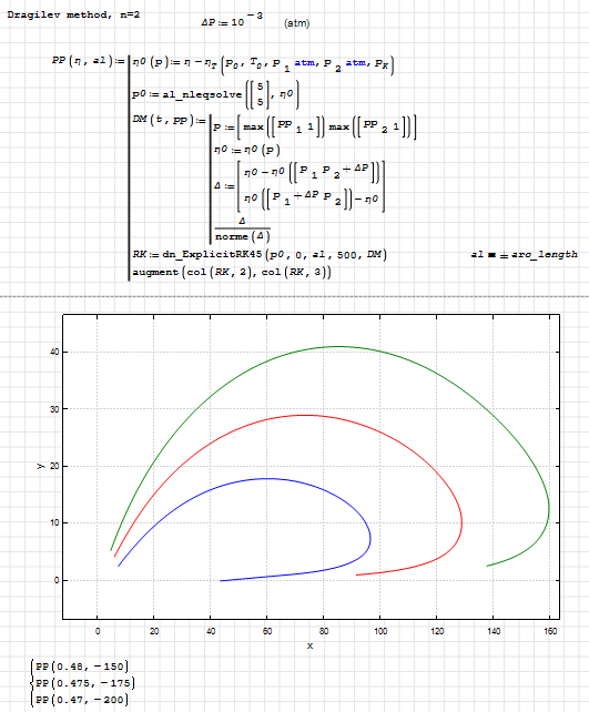

Hi. You can use the Draghilev's method for parametrize a curve.
2RegP-Ideal-Cool_Prop (1).sm (82.56 KiB) downloaded 1229 time(s).
2RegP-Ideal-Cool_Prop (1).pdf (317.07 KiB) downloaded 707 time(s).

My solution
