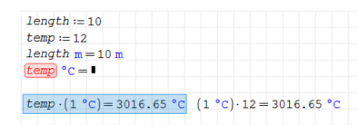

An image to describe the problem:

I can confirm. In addition, parenthesis and isolating the unit causes an error
Oscar Campo 2021/9/17 12:25:00, sergio 2021/9/17 12:36:00

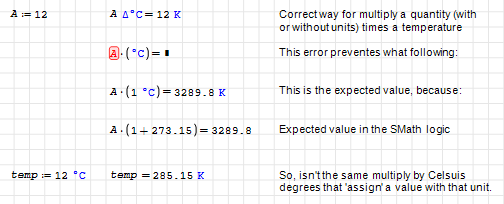

Hi. I'm not sure if that error is a bug or a feature. Because it prevent an unusual task: using degrees scale temperature (those that have an offset) in a multiplication, where the usual is using the "new" Delta scale temperatures. I take my time to understand why it's neccesary to use Delta's, but get convinced after some good Martin's explanations (here).
This image shows why I think that:
Oscar Campo 2021/9/17 15:56:00, sergio 2021/9/17 16:15:00

I agree with Alvaro. The result is actually correct. I do believe it's still a bug, however, as you can add/subtract degC with seemingly strange, but correct, results.
