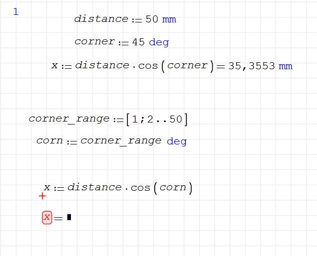

Dear
I have problem with rank along with unit.
Par example: x = 50mm * cos (30 deg) = 35,35mm
But when I use range corner = 0,1,2...50
x = 50mm * cos(corner) don' work!
I try with vector, but it don't work.....
Thanks

in fact, the solution has already been given to you.
cornerRange.sm (6.1 KiB)已下载 1275 次。

If you pay attention to the others solutions, you missed the VECTORIZE function
