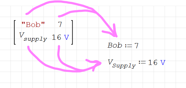

Is there a function or method that would allow a string (or variable name) located in a matrix element to be used as the name to define a variable?
Something like this:
Thank you!

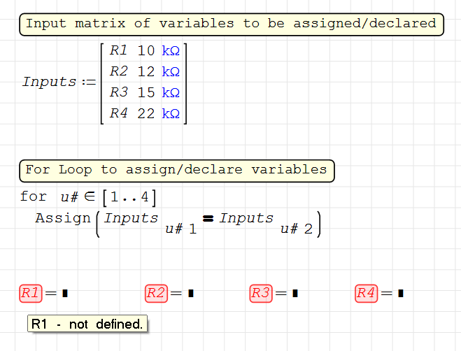

#6 已发布: 2023/1/4 20:02:47
Mark R Harris
Mark R Harris
5个赞,共90个帖子。
Some odd behavior here. When the "=" evaluation is removed the Assign() function breaks:
Assign odd behaviour.sm (3.14 KiB)已下载 1333 次。
Any thoughts?
I'm hoping to be able to assign multiple variables from a matrix like this:
Assign For Loop Broken.sm (5.11 KiB)已下载 1292 次。
#7 已发布: 2023/1/4 21:47:22
churichuro
churichuro
29个赞,共79个帖子。
a small workaround, could be to place the for inside a line command and return a false token value, it is not very clean but it works as far as I can see.
I think the assign command is not evaluated immediately, but has a delayed evaluation, which somehow only takes place after using the "=" symbol.

#9 已发布: 2023/1/5 16:57:04
1,362个赞,共2,276个帖子。
Any thoughts?
Two hints:
- The Assign function needs to be executed in order to do it's work, either by assigning the result to some dummy variable or by requesting display of the result.
- You don't need a loop, Assign() can handle vector arguments
Blatt10.sm (5.31 KiB)已下载 1377 次。

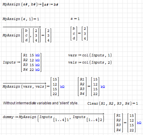

#11 已发布: 2023/1/6 02:15:05
1,139个赞,共1,805个帖子。
Hi. This could be another option.
MyAssign 2.sm (10.52 KiB)已下载 1353 次。

#12 已发布: 2023/1/6 16:25:18
churichuro
churichuro
29个赞,共79个帖子。
@Razonar, as usual with you, you give imaginative and useful solutions, it's great when people share their knowledge and help others, and with such a high technical level. thanks and congratulations.
I have a folder on my computer exclusively for the spreadsheets you share.
2位用户喜欢此帖子
Mark R Harris 2023/1/6 17:15:00, Alvaro 2023/1/6 23:10:00
