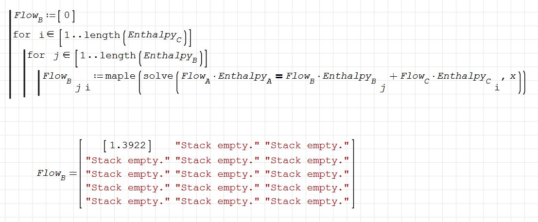

This should have worked ...the data dimensions are correct

I am waiting for a heat exchanger (with temperature loop) which will take x3 months. In the meantime I want to use make up water for temperature control by hot bleeding. Bleeded stream will not be wasted & goes to Cooling Tower makeup ...
Jean, can we use solve() command somehow?
No luck, your document is red with 1 page long error message.
You are trying to plot something, tabulate the data set.
From there, no problem to fit/solve.
Cheers ... Jean.
