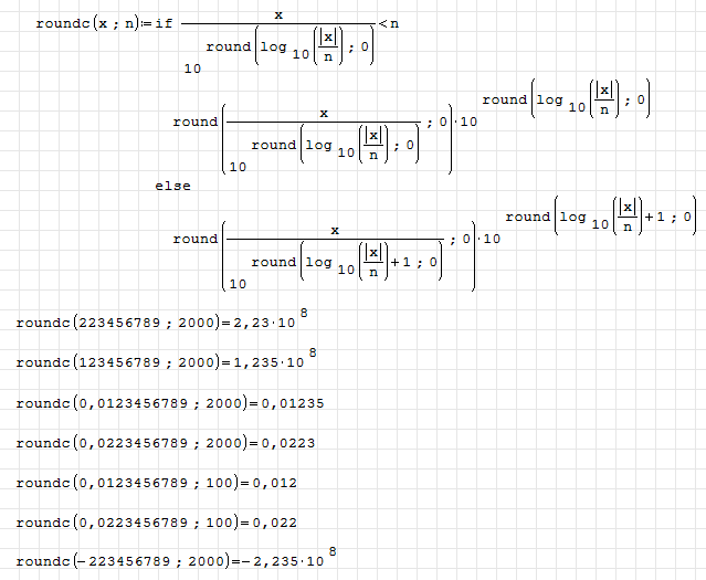

I created a demo file consisting of a function roundc() that does what I suggest.

I improved the function with exceptions handling. improved counts rounding
