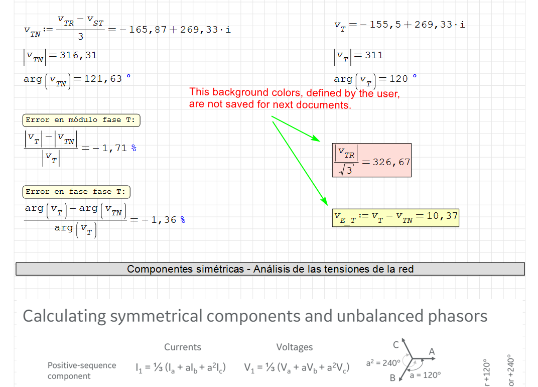

I would like to propose two simple features to be incorporated in the next versions:
1) When ones set the user-defined background colors. Yes, it is possible that these colors are recorded in the SMath so that they can be used in other new documents. Because when you close SMath, the colors defined by the users disappear.
2) Whether an operator can be set to work with 10E-6 engineering notation; 8.352E3 etc in the definition of variables.

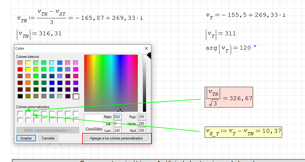

Jean, thanks for the answer. Attached two images to illustrate the proposals,
Proposal 1:
Could the background colors defined by each user be stored so that they can be used in other documents?
Proposal 2

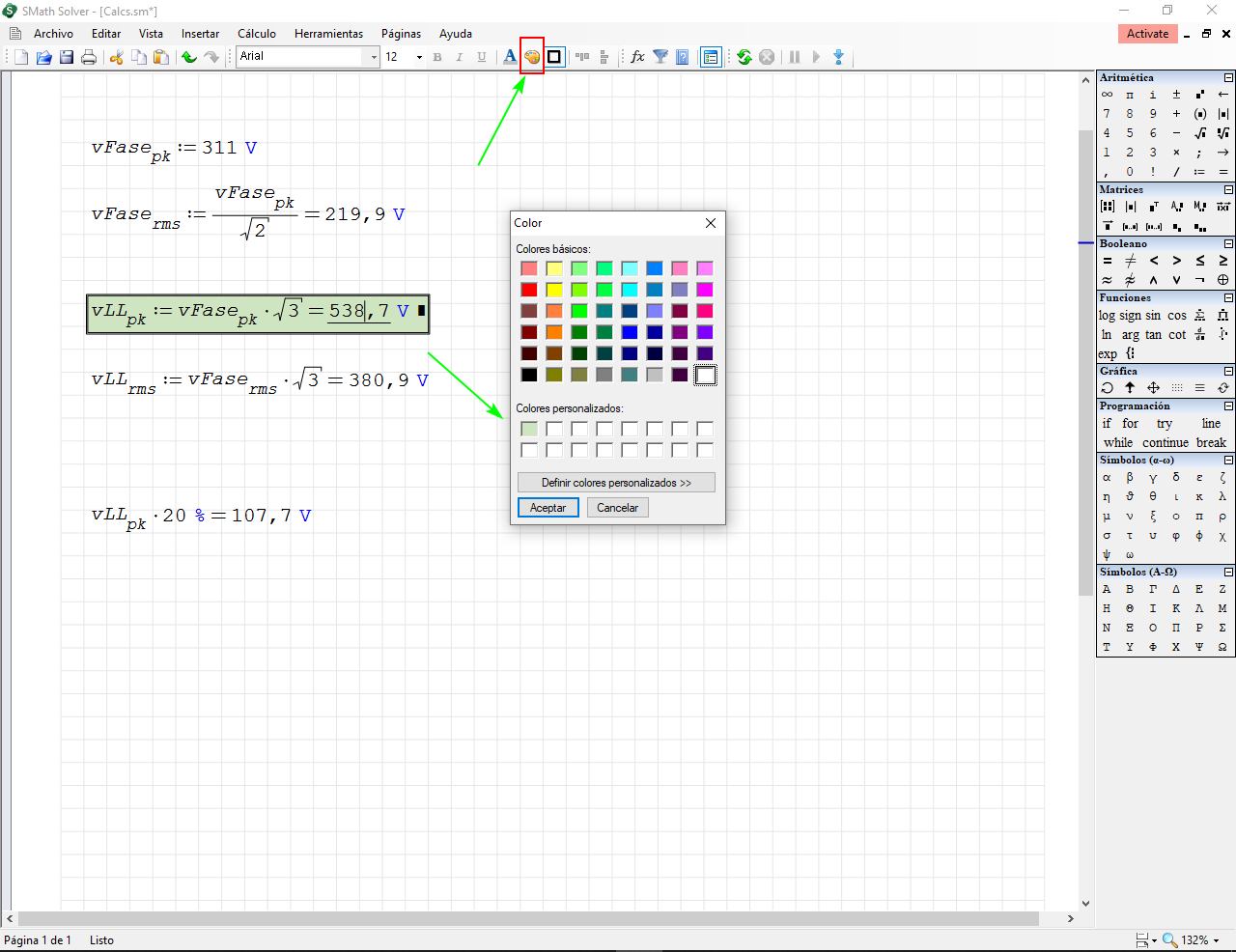

I add one more capture with respect to being able to save on the SMath platform for the funds of the mathematical cells.
Thanks and regards
JuanMa

The proposal is to be able to save in the SMath the colors that one customizes to give background color to the mathematical cells. I don't know how these colors are memorized for use in new SMath documents.
#10 已发布: 2023/6/6 18:59:42
983个赞,共6,866个帖子。
When you open an Smath sheet, it is virgin.
You highlight regions from customized icon background.
You can add/save 16 personalized background.
They are all there for new Smath documents.
They are there up until Smath crashes or you close Smath.
Windows saves those personalized background, not Smath.
