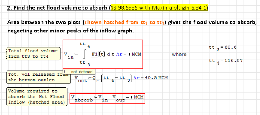

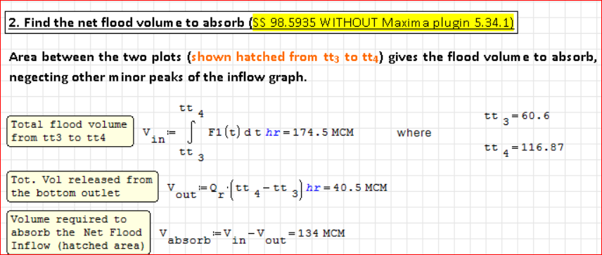

Two images WITH and WITHOUT Maxima plugin 5.34.1 attached.
SS file also attached
Reservoir Flood Capacity Estimation-R1.sm (189.41 KiB) downloaded 1067 time(s).

#8 Posted: 2016/4/4 16:02:28
Ruben Sidranski
Ruben Sidranski
17 likes in 465 posts.

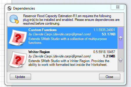

ndtma,
You have other plugins that may not be playing nice ...
I had to update "Custom Functions" and download "Writer Region"
Also, in lieu of the SS version ..., use the new built in "appversion(3)=" function
Looking at your sheet as I write this, but wanted to point out the other plugins.
Confirmed Maxima crash ...

The two plugins were already updated.
Before writing to the forum, I tried a clean re-installation of SS 98.5935 with minimum required plugins installed and updated.
But still the problem with Maxima plugin remains.

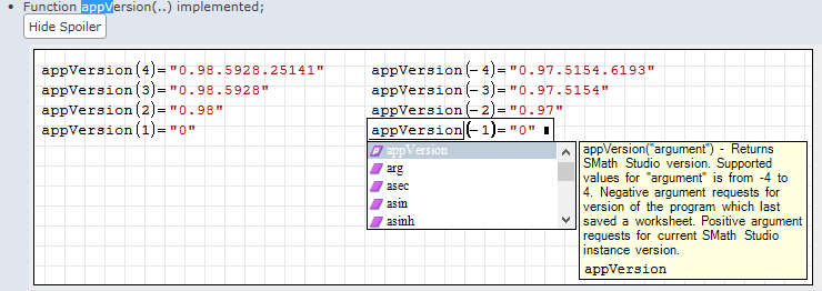

By the way how do you use "appversion"?

#11 Posted: 2016/4/4 22:28:57
