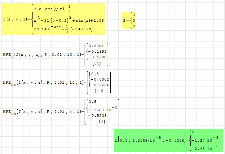

PLUGIN UPDATED :d
- new feature: solvers for systems of equations now accept multiple unknowns names (introduced in the latest BETA + new fixes);
- Broyden convergence criterion revisited (introduced in the latest BETA);
- added HRE.RK(...) (Homotopy root-estimation method, using the Runge-Kutta 4th order algorithm);
- all homotopy algorithms now works as Broyden() and NewtonRaphson() (4 required arguments and a 5th optional argument - see the attachment);
- previous HRE() renamed as HRE.NR();
- plugin Jacobian(...) unlocked (introduced in the latest BETA + new fixes);
- fixed issues with Units in all HRE() solvers.
regards,

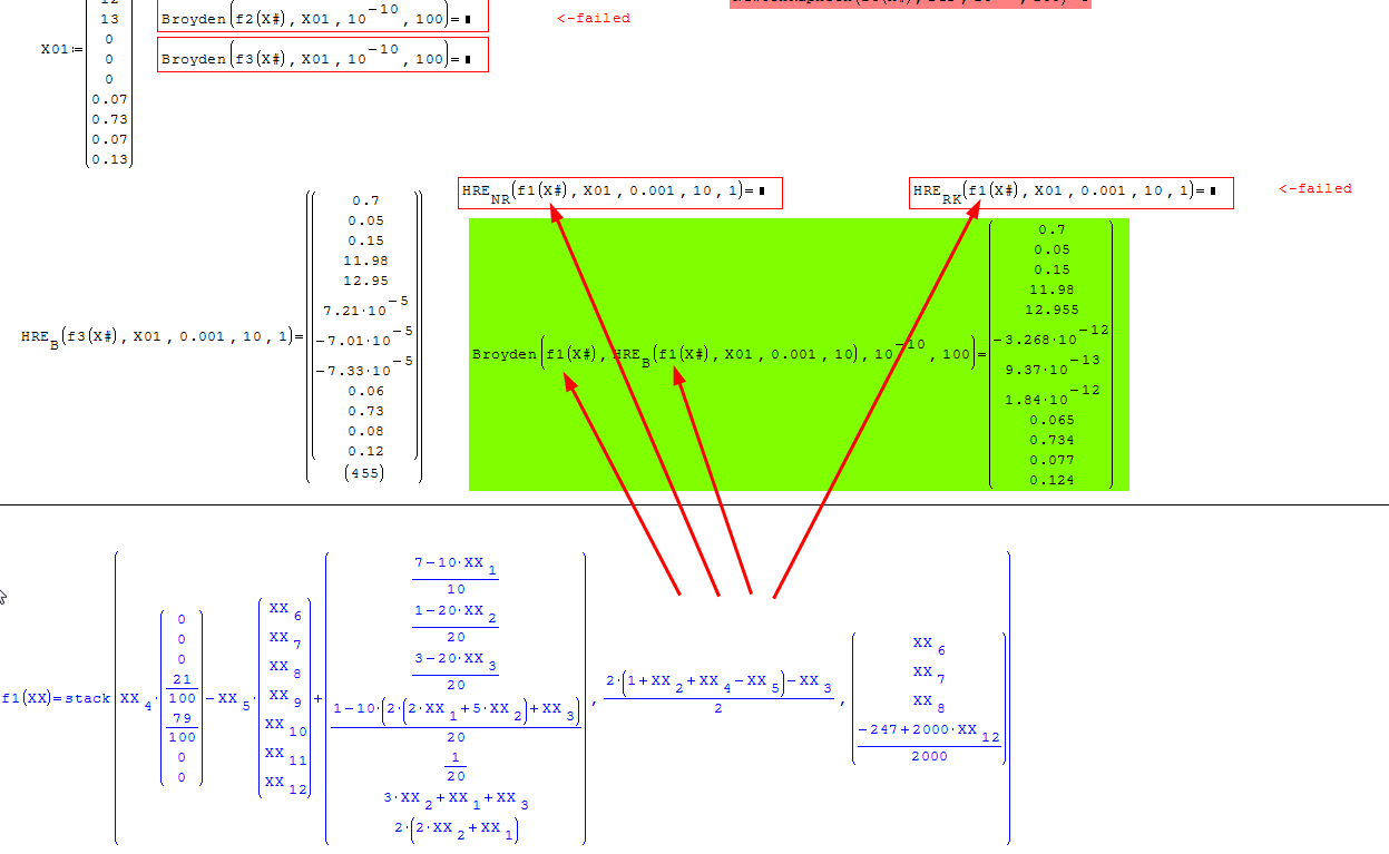

Just a little bit of testing with one my "nightmare" problem. I've mentioned this example already. I think this is one more of the SMath symbolic engine problem, and it my happen that you can define a vector function but can not obtain the Jacobian of it. See the attached file and the picture. I managed to solve this problem initially with HR.B() to get better guess values and then Broyden() could do the job. As I do not know how to force SMath to perform all the symbolic operations (for instance, all the operations inside stack() function - among other things), it seems that HR.B() and Broyden() in these situations are the only way of performing similar things . At the end of the file I did all the things about defining the function manually, and then the situation changed drastically. Anyway, I am satisfied that some progress has been made about this
#75 已发布: 2012/10/2 10:04:09
1,443个赞,共2,936个帖子。
Hi omorr,
I've seen you're example, unfortunately there are many little "issues" regarding the symbolic engine...
For example observes the first element of your f1(), f2() and f3() (look the attachments);
f1()
SMath seem unable to make a symbolical stack of the function; It's not difficult to understand why... the columns of the results matrix (if all it's correct) are the columns of the last stack argument -> 1; the rows are undefined because if [MATH lang=eng]el(X#,2)[/MATH],[MATH lang=eng]el(X#,4)[/MATH],[MATH lang=eng]el(X#,5)[/MATH] and [MATH lang=eng]el(X#,3)[/MATH] are vectors, the result is a vector... exluding the assumption that all unknown elements are numbers or a "size predeclaring", probably the issue could be solved using a "trial and error" procedure on the unknown size, but I think it's a very hard task
f2()
Here there are SMath issues with derivatives... probably it's the same issue of f3() (and the same of this bug), IMHO all related to the symbolic simplification engine...
f3()
Here there are SMath issues with derivatives and elements...
Since all the issues with derivatives involving the Jacobian, so NewtonRaphson(), HRE.NR() and HRE.RK() in this example can not be used (at the moment, at least)

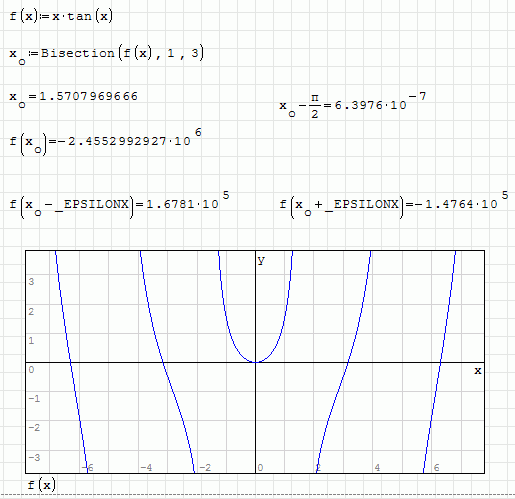

For bisection maybe is better not having both epsilon and maxiters, with only one is enough
I don't agree, because with discontinuous functions (f.e. tan(x)) the maxiters prevents infinite loops.
bisection failure
w3b5urf3r
Epsilon and maxiters for bisection is redundant. Even it's more easy with maxiters, is better to take Epsilon (one for each axis, but that is not related with maxiters redundance). In the code maxiters is calculated as N. Actually, the main loop can be implemented with a for loop.

f1 := 3.*x-cos(y*z)-0.5;
f2 := x^2-81.*(y+0.1)^2+sin(z)+1.06;
f3 := 20.*z+(e^(-x*y)+(-3.+10.*Pi)/3.
1)x=0.499999999686162; y=-6.029115021 10^-10; z=-0.523598775196563;
2)x=0.498144680773833; y=-0.199605897856040; z=-0.528825978056676
f1=-1 10^-9;
f2=1.0 10^-8;
f3=1 10^-8;
Regards.
Ahhhh, previously I understood that you wanted to remove completely (in the function) the maxiter, not to replace it with the number of iterations provided... you're right, excuse me
BTW the plugin single equations solvers actually supports the 2nd Epsilon, but I have not yet updated the reference sheets.
