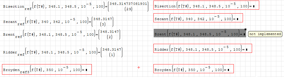

Here is a bit of testing the Broyden plugin. It is a clasical "driving crasy" situation with multiple solutions. It was mentioned by kilele in the link to the document http://en.smath.info/forum/yaf_postsm7678_solve---and-roots-----again.aspx#post7678
Your plugin failed (if I did not do something wrong) but do not worry about it - it is a common situation. The problem is why "Can not calculate" error returned. I do not know. My function returned another solution than few Newton-Raphson iterations or roots(). I also used another software that uses some kind of broyden algorithm and here is the result - the same as roots() returned
>function f(x):=[(x[1]+3)*(x[2]^3-7)+18,sin(x[2]*exp(x[1])-1)]
>x0:=[-0.5,1.4]
[ -0.5 1.4 ]
>f(x0)
[ 7.36 -0.150285529841 ]
>res:=broyden("f",x0)
[ 0 1 ]
>f(res)
[ 0 0 ]
Here is the picture and the sm file
Broyden_testings-1.sm (53.53 KiB)已下载 2069 次。

Added a SMath file with examples for the Bisection() function.
Wrotewow, have you used bisection as an initialization of broyden ?

Again since Broyden is not globally convergent, bisection might be interesting as an initial approaching to the roots

This is one of my working problems I was already mentioned Primer 65a and struggled in SMath with. I reported there the problems of solve() and roots() solutions.
I used it again for testing and attached it to this post. It seems the problem is a bit numerically "tricky" for solving in SMath. The original file is not working in the recent SMath version, neither solve() nor roots() (error message about T as undefined variable - not quite sure why). Here I attached the revised file - just removed eval() I was talking about in the previous post. Fortunately, solve() will now get the more accepted result
Regarding this problem, I am satisfied that at least one of the possible tool in SMath can give the result.
Primer65aa.sm (41.67 KiB)已下载 2102 次。
Without insight into the nature of the problem, root finding is more or less blind search, this is why I suggested a multidimensional bisection method for a initial guess with just a few iterations.
With some insight into the nature of the root, Newton’s method using derivative information, and Broyden’s method using only function information seem good candidates.

I omorr, i'll check this issue ASAP, especially because in this case the script seems to work while the plugin don't work...
about eval(), you cannot use it where there are undefined variables because the function "force" the numeric evaluation.
