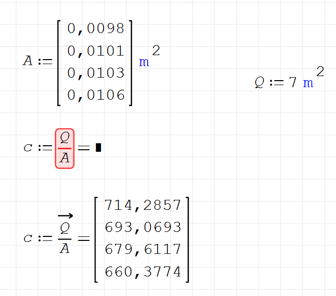

Hi, I got stuck trying to do the following:
The divisor matrix is:
I need the c.mn results
I'll appreciate some help, thank you in advance

I imagine you want to achieve element-wise division. You can use the vectorize function.

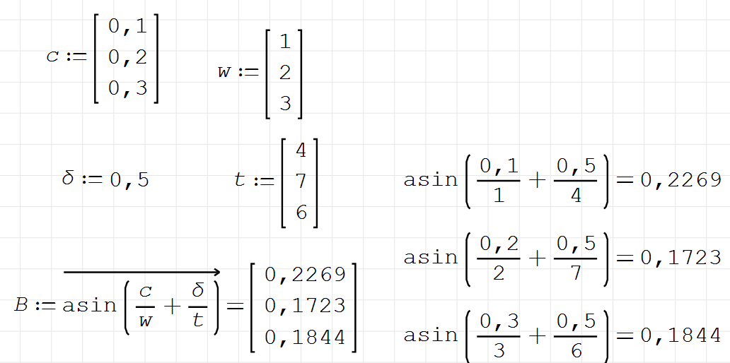

Thank you, it worked. But now im having a different problem, as shown below:
Wondering if it's truly unsolvable in Smath since I cant have scalars there bc I have to vectorize the functions

The external function "asin" should be evaluated element-wise.

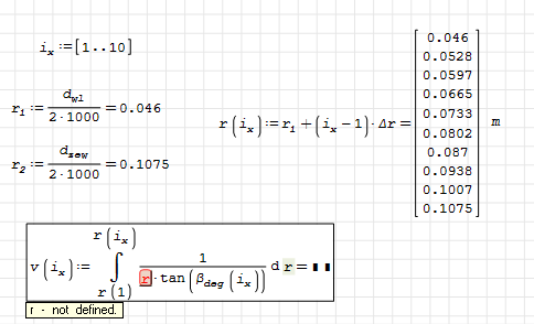

Thank you a lot, it worked. Got stuck again here:
#6 已发布: 2026/2/11 19:15:32
127个赞,共342个帖子。
Don't confuse subscripts (obtained, for example, with a.1) with array or matrix indices (obtained, for example, with a[1).
sergio01.sm (10.77 KiB)已下载 724 次。
