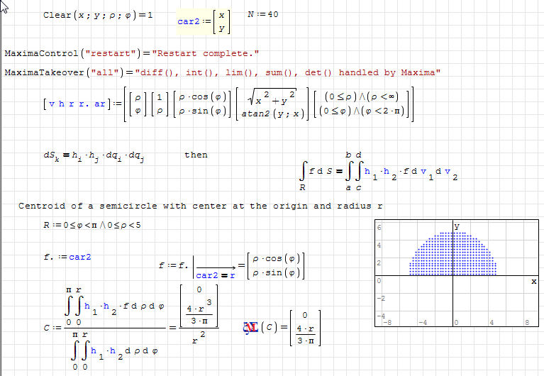

Polar integration in symbolic version:
Integral%20in%20polars_Kr.sm (57.53 KiB)已下载 1522 次。
