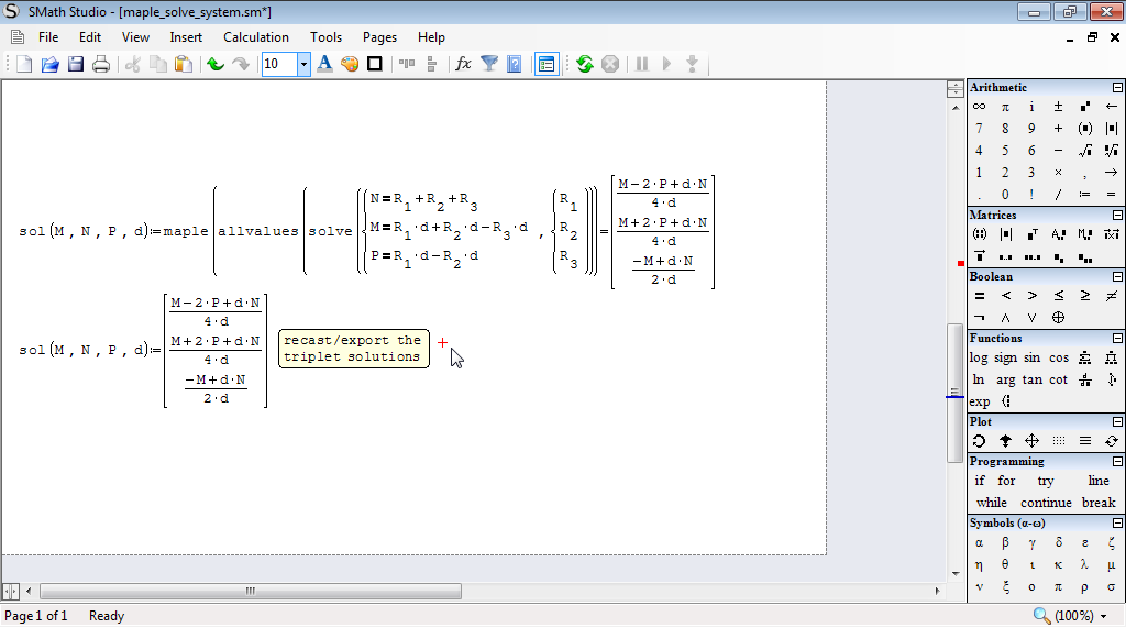

Explicit the Triplet [R1, R2, R3]

kompre,
You can use the Solve command of the maxima plugin. maxima_Solve_system.sm (7.91 KiB)已下载 1259 次。
P.S. I believe that Jean's solution is not correct because the solutions are not ordered

kompre,
Thank you!
This seems to be exactly what I was looking for
(I try to use the thank button, but get an error, so accept non statistical gratitude :d )
