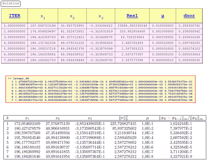

#1 已发布: 2018/7/17 21:17:58
CBG
CBG
78个赞,共312个帖子。
Levenberg_Marquardt_Code_CBG.sm (137.38 KiB)已下载 1373 次。
#2 已发布: 2018/7/18 00:03:02
983个赞,共6,866个帖子。
Thanks Carlos,
For meditation. Hover the pointer on φ(x,β) to see Conjugate Gradient.
The model is puzzling, if you want so: can try expGrow as an exercise.
Genfit Minimize MODEL Test.sm (39.95 KiB)已下载 1299 次。
