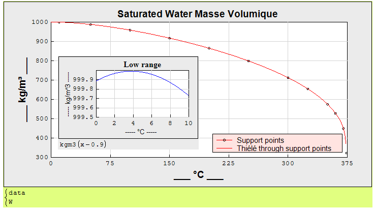

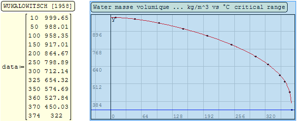

WroteHarvey,
If you wish, you can exercise your cubic(s).
The red fit is one piece.

WroteThe plot below shows the Prode equation used for the liquid water density. It does well through out the data range, including near the critical point. The equation does not work with a reduced temperature of 1.
In my times, Prode was the Air Liquide Bible, in English too.
I have the water rho IAPWS from B. Spang in Mathcad.
Very many data sets have model(s).
Otherwise, we rescue via interpolation methods, mostly:
1. Padé normalized rational fraction.
2. ChebyShev linfit.
3. Thiélé inverse interpolation.
4. Piece wise LSQ [can't make it work Smath].
5. Convolution Polynomials [Laser].
Some data set can only be fitted by hand [Chemist].
All that said in short, why not re-thread to be more attractive ?
Prode Discussion would attract greater audience.
