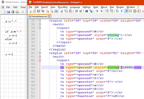

WroteWhy does this return false (see image below)?
Is there anything I can do to correctly evaluate this?
Without the file it can be the same as gambling. My best guess is that when copying and pasting text many times SMath takes the unicode character instead of the simpler ASCII character, as in the attached file.
UnicodeIssue.sm (2.68 KiB)已下载 1522 次。
Conclusion: do not copy and paste quoted strings in SMath, but rather write them.
