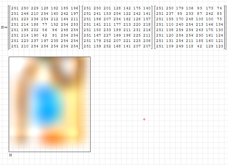

Alex, can you see this matrix in the image region?
mat(mat(251,250,229,128,182,185,196,251,246,210,254,160,242,197,251,223,236,254,212,164,211,251,214,188,77,152,254,253,251,195,202,56,96,248,254,251,214,190,42,91,254,254,251,223,237,197,235,254,254,251,210,254,254,254,254,254,8,7),mat(251,250,201,128,142,175,140,251,241,153,254,122,242,141,251,186,207,254,162,128,157,251,161,211,177,213,220,218,251,150,233,189,211,231,216,251,167,227,169,198,225,211,251,179,252,207,221,225,208,251,159,252,168,141,207,207,8,7),mat(251,250,179,106,93,173,74,251,237,95,233,87,242,85,251,155,170,248,100,100,75,251,110,240,254,213,146,134,251,108,254,254,243,175,130,251,120,254,254,230,161,124,251,131,254,211,185,160,121,251,109,249,118,42,129,123,8,7),1,3)
#72 已发布: 2016/5/16 14:58:59
Alexander O. Melnik
Alexander O. Melnik
127个赞,共498个帖子。
Hope its not one of those hard to trace bugs that are hardware / OS dependent
M.render.sm (8.55 KiB)已下载 1513 次。
#73 已发布: 2016/5/16 15:29:20
1,443个赞,共2,936个帖子。
Thank you! Solved, seems I was having a newer version installed (?)
Uninstalled and downloaded again, now it works :d

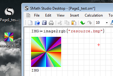

#76 已发布: 2016/5/17 08:03:34
1,443个赞,共2,936个帖子。
Using latest Nightly Build of SMath Studio and the last beta of Custom Functions.
Alex, can you make the double-click feature enabled just on the canvas of the region? It is really annoying while trying to edit the math content
#77 已发布: 2016/5/17 10:24:17
Alexander O. Melnik
Alexander O. Melnik
127个赞,共498个帖子。
Could you please provide an example? I have just opened my balloon test file and nothing happens if I double click anywhere on the region.. as it should be.
