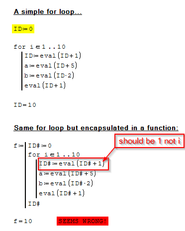

This example should be self explanatory. I expected same output in both cases. Is this a feature or a bug? Caused disaster in my formula logic.

Feature
You are using pass-by-reference, that assign a value to an input argument when it is the target of an assignment inside the procedure (see here f.e.)
the last assignment is missing; to assign the same value both to the result and to the input variable you have to define ID#:eval(ID#+1) even after the loop.

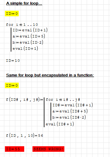

Davide, pass by reference assignment is intentional. What i do not understand is why
The result is 56 and not 10 - I used eval() to assign a static value to ID#, or so I thought, but ID# was assigned a dynamic ID# = ID# + 1, which was not the intent.
Hey, in first block, you incremented ID by 1 in loop; in second you do it by self-incrementing i!

WroteDavide, pass by reference assignment is intentional. What i do not understand is why
Ah! Now I see it.
WroteHey, in first block, you incremented ID by 1 in loop; in second you do it by self-incrementing i!
This is the cause

Thank you all; so far I understood that something should be clear to me by now, but its not. What can I do to encapsulate a seemingly simple for() loop in a function that produces same result (10)?
