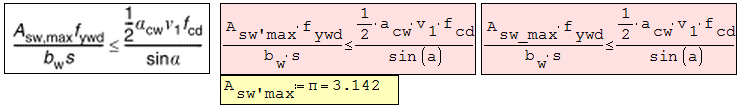

I absolutely appreciate the importance of this feature for engineering documents. In a 100-page proof of strength you don't want to invent your own symbols if you want someone to comprehend your work.
I can't reproduce the issue with 6995:
if I write the document with komma as argument separator, I simply can't type a komma to the text index unless I go to special character mode using Ctrl-K. Names with such kommas survive. (german keyboard, win7)
Without using ctrl-K I just can type periods to separate individual text indices.

Directly, you can use only the decimal symbol in subscripts (whatever is the one set in your SMath Studio).
To add a generic symbol you can use CTRL+K or CTRL+SHIFT+K and switch to the special characters mode; this however isn't localization aware, thus if you share your document, something like the one below written for comma as arguments separator and period as decimal symbol, will stay in this way even for who has f.e. comma as decimal separator and semicolon as argument separator.
I think that following the path of special characters and fields, would be possible to introduce something like /./ and /,/ as serialized placeholders for localization-aware decimal symbol and argument separators inside strings; the way to input them obviously wouldn't be CTRL+K (because you might want an immutable comma/period) and neither direct typing (because argument separator is required to create new arguments inside functions).

As an engineer I use the Eurocodes all the time. In Smath I always use the underscore "_" instead of the comma "," for the definition of variables, as shown above in the post of Jean:
Asw,max → Asw_max
because it is the easiest / fastest way of typing, without the risk of making fault formulas.
And I had never any complaints from anyone who checked or commented to my calculation reports for this way of typing.
Regards, csb
Asw,max → Asw_max
Regards, csb

WroteAsw,max â Asw_max
... just a bit pest in numerator vs apostrophe.
