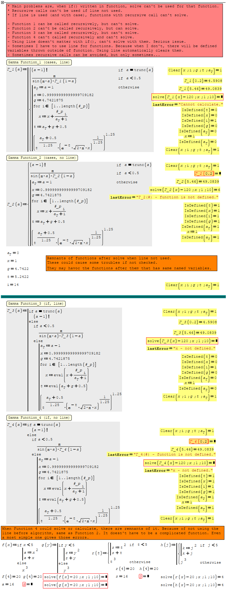

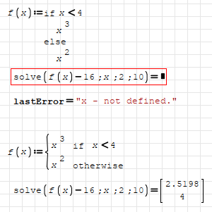

Update of statement:
solve(), roots(), FindRoot() doesn't like if() function.
However, they can solve when cases() used instead of if().

I have diagnosed the symptoms with solve bug.
Made a page about this and tried to explain with detail.
somebugs.sm (54.72 KiB) downloaded 1244 time(s).
somebugs.pdf (522.2 KiB) downloaded 579 time(s).

#3 Posted: 2021/6/11 09:21:57
solve(), roots(), FindRoot() doesn't like if statement.
if/else was reported SS 5346.

otherbugs.sm (13.7 KiB) downloaded 1170 time(s).
