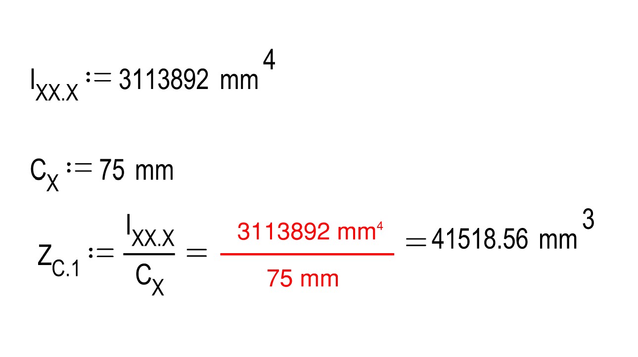

Hi all,
I want to show the amount of variations in the formulas, like the red part in the below image.
Currently Smath just calculates the result from the formula and does not show the amounts in the formula.
Can anyone help me with this?

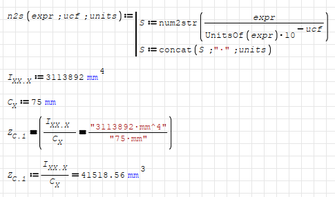

However, you can write some tricks and functions to show your amounts.
But it will be time consuming, hard and not practical.
In example below there are a lot of confusing aspects.
I post it for you to show it can be done and check what is done.
It will not work for all situations however.
I will humbly suggest you to not seek showing amounts.
Especially if they contain units.
show_amounts.sm (5.58 KiB)已下载 1413 次。
