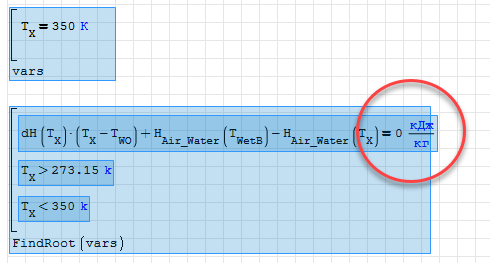

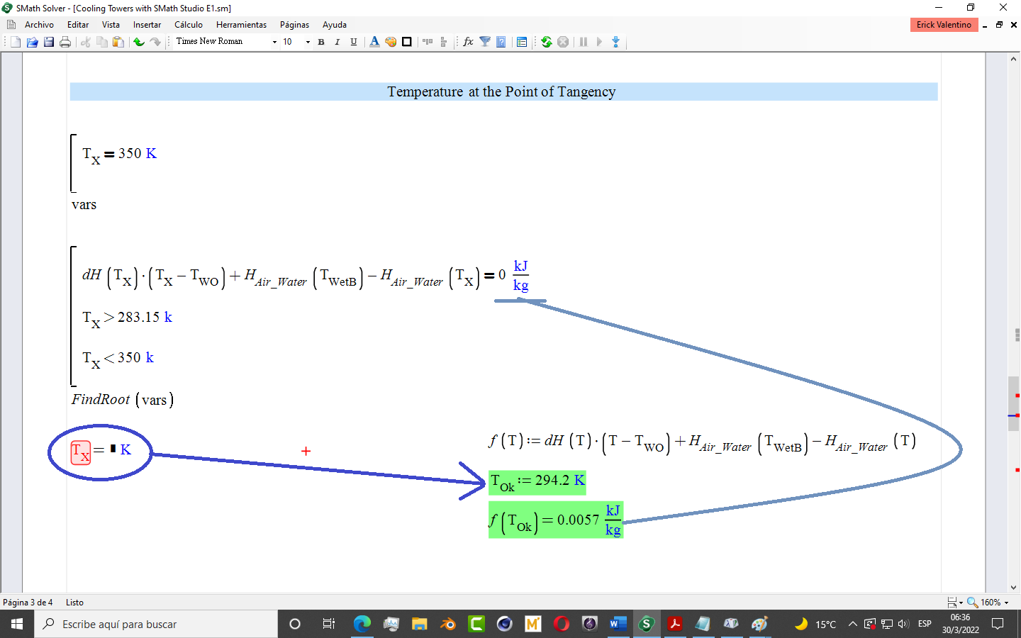

I try to find the value of a temperature that when replacing it in an equation the result is 0 KJ/Kg. I have already done things like this, where I propose a temperature or pressure and with the "Root" or "Solve" command I get the result, however this time I am using CoolProp instead of equations of state and polynomials, I don't know if that affects, you know by the units and things like that... does anyone know how to do it?
I already tried with a mathcad solve block although I think I'm not using it well, approximately the temperature is around 294.2 K, it would be great if this can be done with a "Root", "Solve", or "FindRoot" so as not to have to do it with a Newton Raphson
thank you very much for reading me

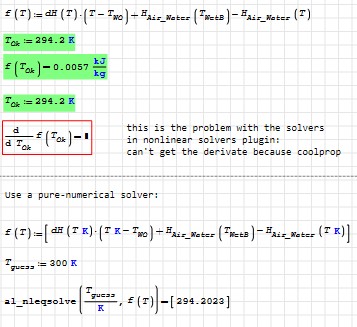

Hola Valentino. The nonlinear plugin solvers don't work because they can't get the derivative of the function. SMath's diff function does not work on functions defined in plugins, in this case coolprop. You can see that in this post: https://en.smath.com/forum/yaf_postst12504_Uneval.aspx
To get the root you need to implement your own pure numerical solver or use al_nleqsolve.
Cooling Towers with SMath Studio E1.sm (69.03 KiB)已下载 1377 次。
PD: It's a bit awkward having to define f(T) as a 1x1 matrix, while accepting guess as a scalar. I think that an interesting improvement in al_nleqsolve could be to accept scalar functions for the case of a single variable, and also return the result as a scalar, and not a 1x1 vector.
