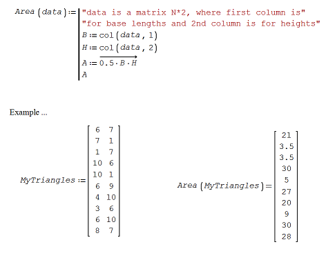

Hi Danuko, maybe an easy way to do you need is program a simple function and define the input as a matrix:
and here is the file: TriangleAreas.sm (5.6 KiB)已下载 1404 次。
Best,
Oscar

I wonder whether you really want to input hundred of triangle specifications inside SMath.
Using matrices for input usually is a nightmare because you neither can insert rows nor can you delete ones without resorting to some programming.
You could, however, build a sort of editor with append, insert, delete functions for the data storage.
I'd prefer a multicolumn text file (e.g. csv format) and the use of the importData() function.
