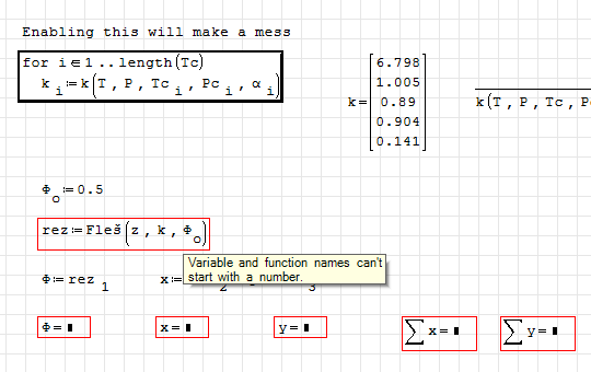

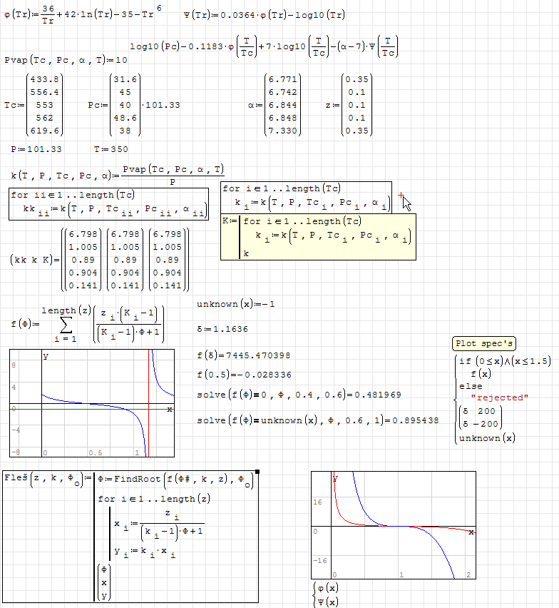

It seems that "i" still causes some headaches. I used a part of one of my standard files and get this rather strange error message
See please the attached file. I have no idea why the famous "i" variable made a mess here
i_problem.sm (20.05 KiB)已下载 1795 次。
It does not make mess 5346.
FindRoots [Φ.o] looks under defined wrt Maxima that needs a function
whereas it is not a "root". A "root" crosses the X axis. Φ.o can be
anything in the Catesian plane. You can solve point by point but
NOT on a range. Mathcad 11 would not do either. You are in fact,
in other words, "inversing a function". The Mathcad way is the
"seeded root scanner" over a prescribed discrete range ...
as fast as a lighting strike !!!
Cheers Radovan: Jean
Radovan_2.sm (14.96 KiB)已下载 1889 次。

Thank you Jean for your analysis, but I think that here is again introduced some glitch regarding variable i and for loops. I can not figure out what actually happen here, but I could see that there is something that causes that strange error message. Somehow, in the summation instead of variable "i", you get the actual value of i (I do not know why) and it complains because variable can not start with number.

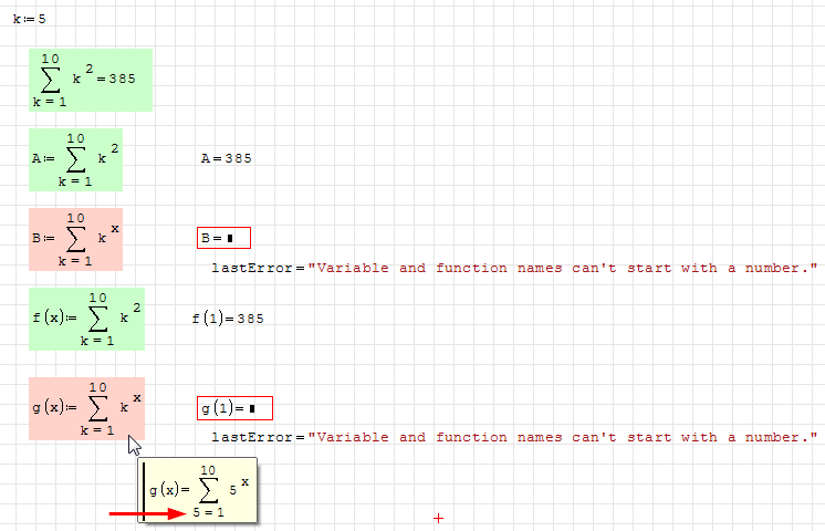

It is not about i, there is a bug in preprocessing wrt the iterator argument of sum() when unknowns are involved in other arguments on definitions; the iterator name is replaced with a value, then when sum tries to evaluate the name is lost.

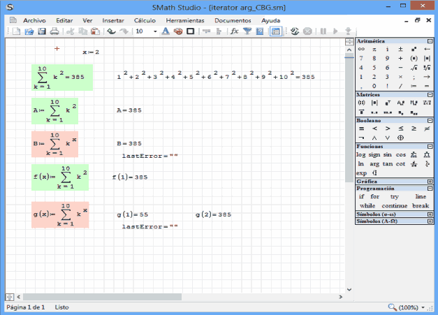

Must be not define the variable k, which must be defined is the variable x, because apparently, the sum function does not accept symbolic evaluation
iterator arg_CBG.sm (8.35 KiB)已下载 1742 次。
