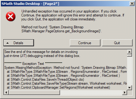

Just this mystic message

Note that by installing 5935, it zapped the icon of 5346. All the former 5346 plugins
are the in the folder but 5346 is all dead and all the work sheets.
