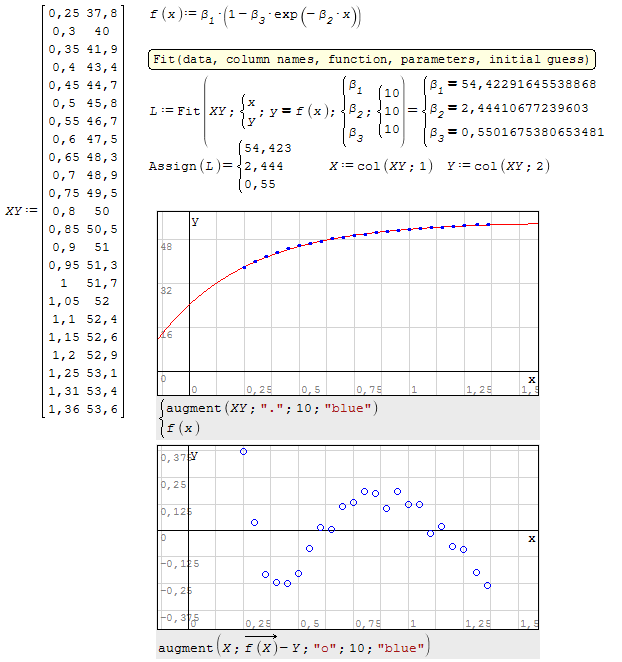

#2 Posted: 2018/3/22 23:31:59
The model function is excellent.
... here is the Genfit to this model.
Genfit Thermal Insulation.sm (33.25 KiB) downloaded 1013 time(s).
#3 Posted: 2018/3/23 07:17:02
1,353 likes in 2,264 posts.
Demo for usage of the Fit() function (Maxima)
Genfit%20Thermal%20Insulation_Kr.sm (9.13 KiB) downloaded 1141 time(s).
