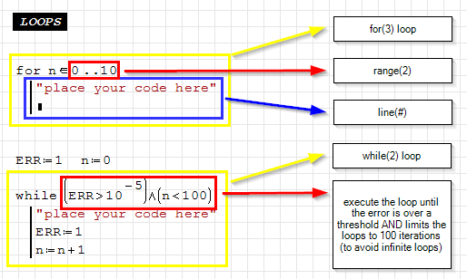

Hello cube, what's exactly the point?
To build a loop use a for or a while statement (something like in the attachment).

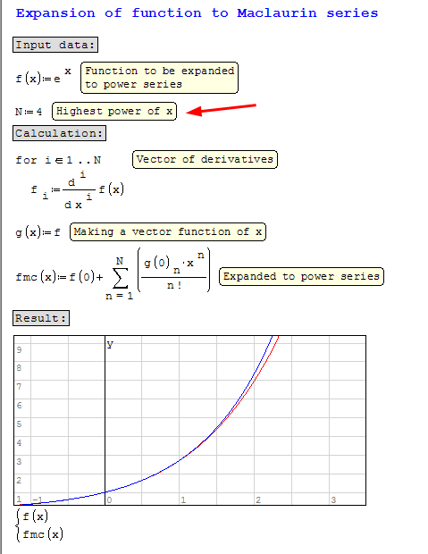

Open Help->Examples and choose "Expansion of function to Maclaurin series", than open it. You can then choose the function as well as the highest power of x.
