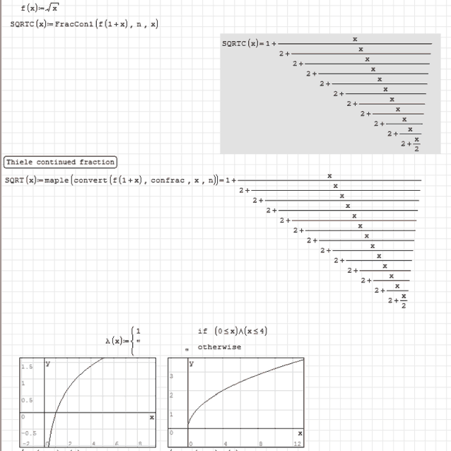

Four examples of Continuous Fractions

WroteFour examples of Continued Fractions
Thanks Carlos ... works well.

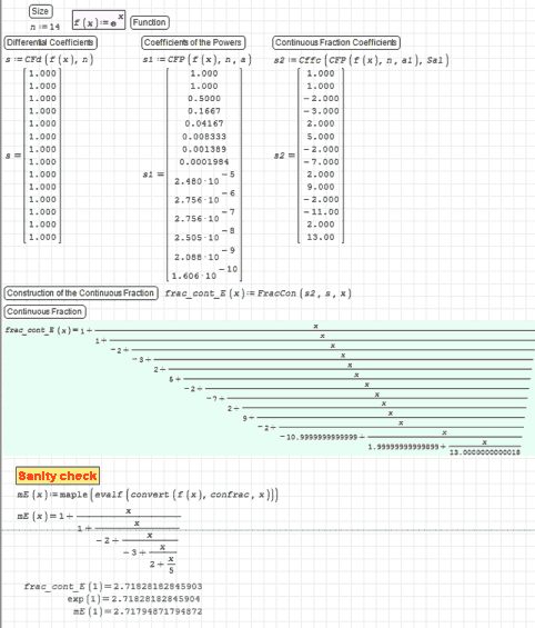

Hola Jean
Thank you very much for your examples, they have helped me to correct
a fault that was presented in the ACOS (X) function, where the value
of "Phi () / 2" was not included.
I have merged all the algorithms in a single function for ease of use.
All the examples you provided work perfectly with the algorithm for
the conversion of function to a continuous function.
