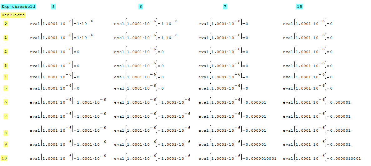

Hi all,
I noticed that the output of the eval() function is related in some way to the decimal places setting... Don't know if it's a bug or a feature, but seem it's not a rule (see the screenshot)
IMHO it's preferable to cancel this behavior...
best regards,
w3b5urf3r
eval.sm (8.69 KiB)已下载 1555 次。

I might not quite understand your point, but I think this is a matter of rounding to some number of decimal places and it is ok with me when I put 1.05 and us 1 decimal place to see: 1.05=1
WroteI might not quite understand your point, but I think this is a matter of rounding to some number of decimal places and it is ok with me when I put 1.05 and us 1 decimal place to see: 1.05=1
I'm not sure...

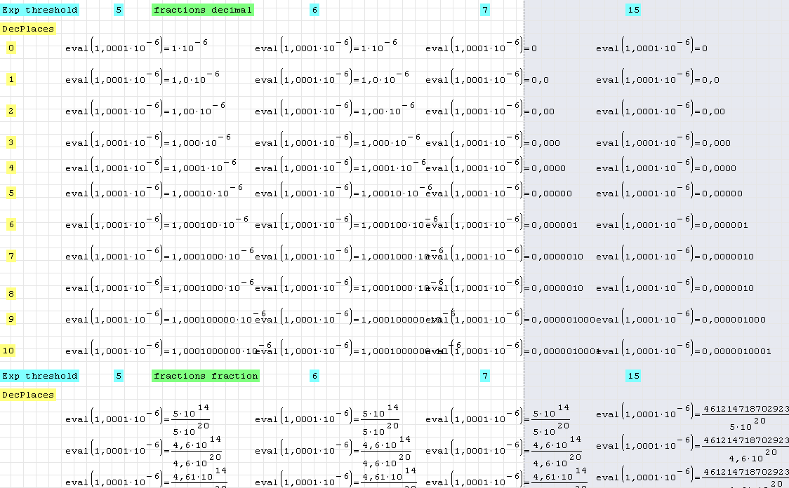

eval.sm (44.55 KiB)已下载 1581 次。
Sorry, Davide - I do not get it
And where all those fractions come from. I delete them, press equal to - and got the fixed/exponential numbers

Maybe I'm wrong in my first post, but I don't understand from where the values in the red boxes comes
me too... SMath 0.96.4884 on my notebook... o_oWroteAnd where all those fractions come from. I delete them, press equal to - and got the fixed/exponential numbers

The trouble comes from the fractions setting in the context menu and how it is processed.
If you switch to decimal, then everything is fine. Default setting is "auto". If set to "fraction", then odd fractions are generated, which are far from minimal (or just correct) representations of the given number.
Also, for more clarity, I switched on the display of trailing zeros.
EDIT: line 8 is same as line 7, sorry, but you still get the point...
2位用户喜欢此帖子
WroteThe trouble comes from the fractions setting in the context menu
thank you very much Martin, this solve my issue shown here (2nd post); the global fractions setting was switched from "Numeric" to "Auto"...
