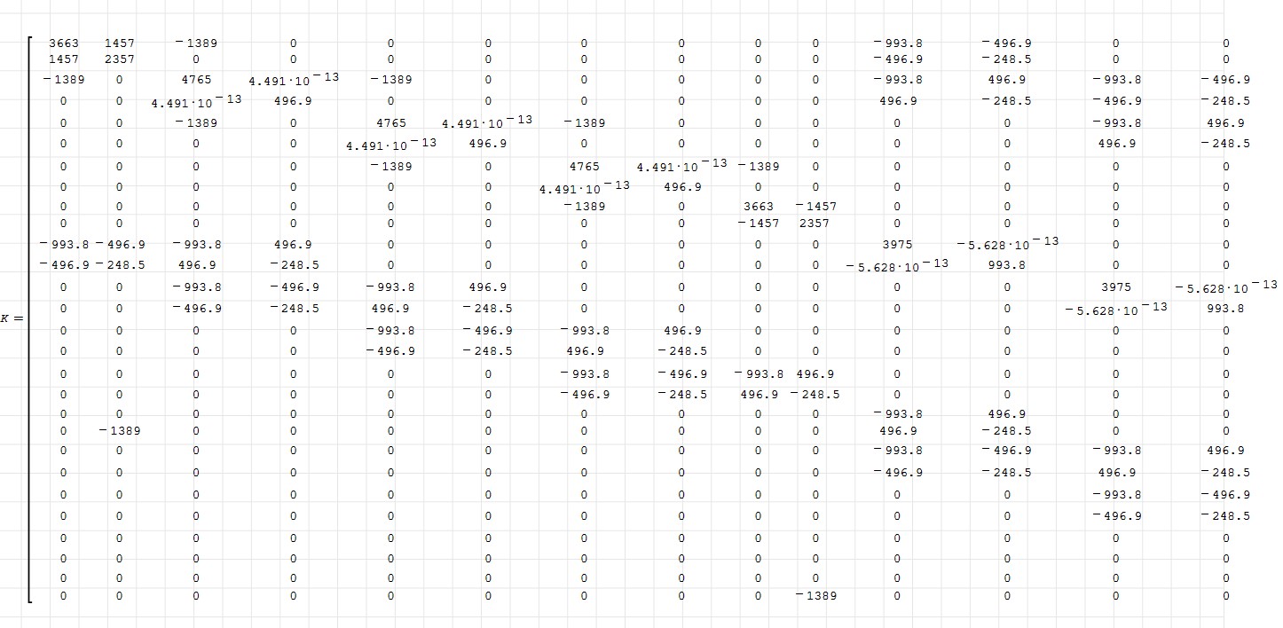

WroteThanks, Alvaro. I've attached a screenshot of part of the K matrix in case that will spark any thoughts, but not sure if that will be helpful. I could upload the .sm file as well if that would be easier.

From my point of view, your matrix looks like a stiffness matrix from a Finite Elements Method approach, if that is the case, I was working on that some time ago, and I found some issues trying to solve the equation [x]=[K]^-1*[F]. My solution was to use Gauss elimination or a solver for a banded version of [K].
Anyway, as mention Alvaro, it would be great if you attach your .sm file to check it.
