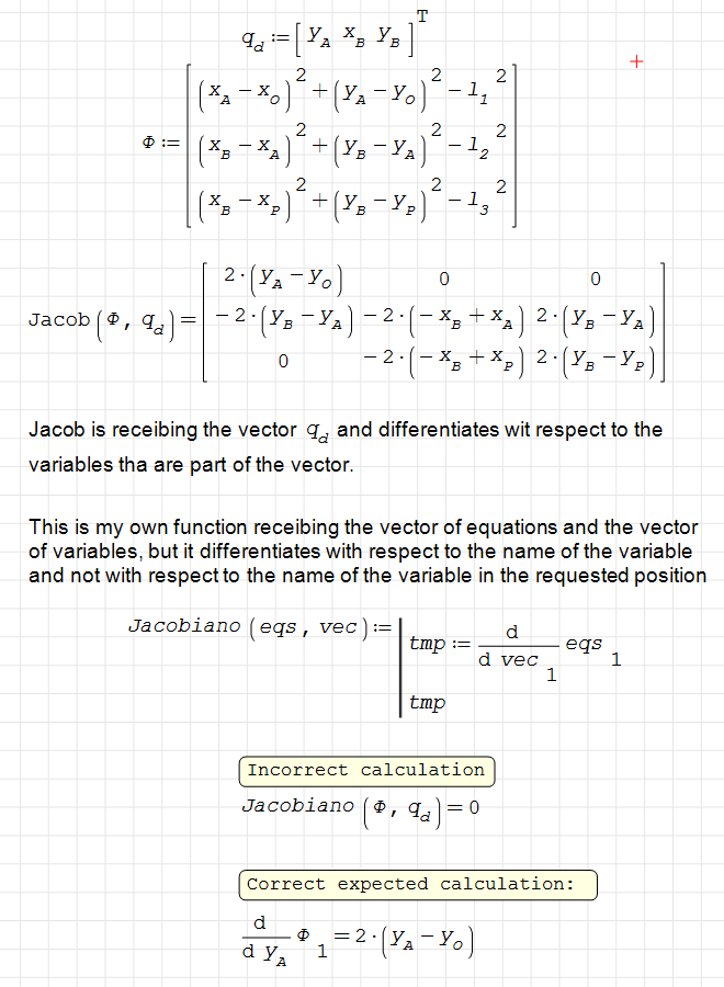

This is to use the "diff" function to differentiate an expression with respect to the variable that is an element of a vector, just like the "Jacob" function does. Here is an example:
Hope you can help me and tell me how to derive a expression with respect to the correct varible name.
Best wishes to all,
Mario
Dear Friends:
I'm relatively new to Smath and I have a question that I've been trying to solve for a long time and I can't find a way.
Best wishes to all,
Mario

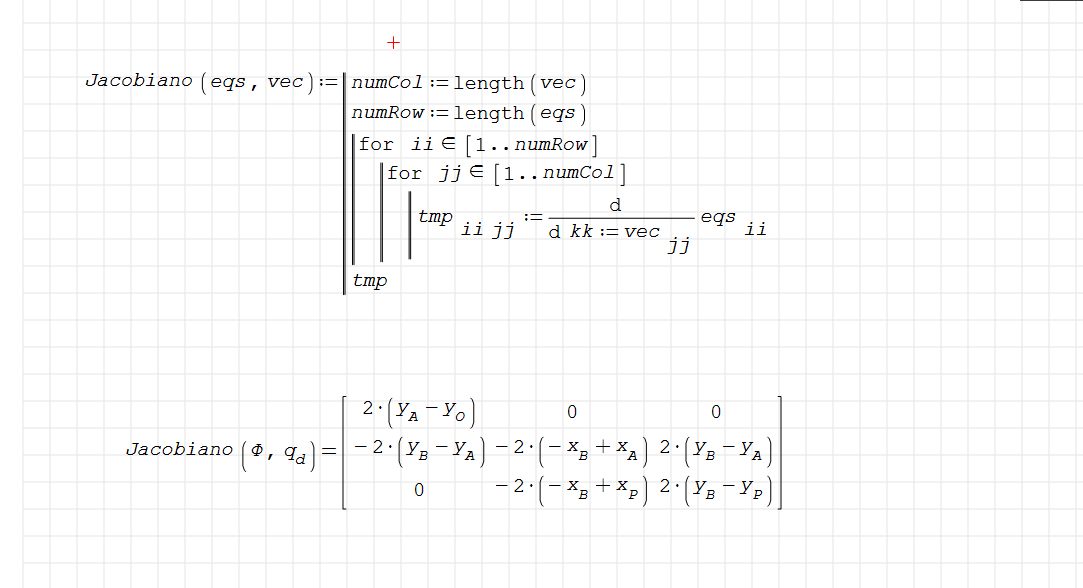

I could not tell you why this works.. but assigning another variable the value of q.d[i seems to work.
Jacobiano.sm (8.76 KiB) downloaded 1067 time(s).
WroteI could not tell you why this works.. but assigning another variable the value of q.d[I] seems to work.
Thank you very much!, it works fine. I am also wandering why, but it works!
WroteSomething like this ?
Maths Jacobian Example.sm (7.94 KiB) downloaded 1077 time(s).
Thank you very much, the solution proposed by alyles works fine.
The worksheet you are attaching is something different. But thank you very much in any case.
