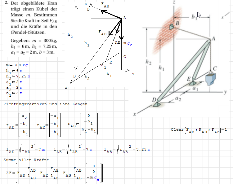

#5 Posted: 2017/2/5 18:31:25
1,353 likes in 2,264 posts.
There are some obstacles when trying to do (symbolic) vector algebra and calculus in SMath.
- You can't declare symbols as vectors or matrices (with non-commutative multiply.
- Therefore, symbolic simplifications may fail or produce wrong results.
- The cross product is overly picky about type of arguments, it requires expressions of type
matrix. Even just multiplying by a scalar will break it.
In the attached sheet, the attempt was made to solve some simple static problems using vectors.
If numerical values are given, this works to a certain degree.
The third, symbolic problem required a bit Maxima magic and manual copy and paste in order to get the solution.
There are some pages on matrix/vector operations in the interactive handbook.
13 Gleichgewicht im Raum.sm (196.02 KiB) downloaded 977 time(s).
